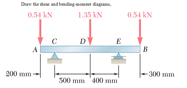

  • Another participant emphasizes the necessity of calculating reactions at points C and E to construct the shear and moment diagrams.
  • A participant explains their calculations, stating that the horizontal reaction at C is zero due to the absence of forces in the x direction, and provides a value for the vertical reaction at E.
  • Another participant challenges the assumption of zero reaction at C, arguing that the beam cannot be in equilibrium with a reaction at E and zero at C due to the presence of a net moment around C.

For one thing, you haven't calculated the reactions at C and E. Until you do, you won't be able to construct the shear and moment diagrams.
If I am interpreting what you posted correctly, you have all of your reaction at E and none at C. Why?
Cx= 0 b/c there are no other forces in the x direction. Ey = 2.43 from sum of moments, and Cy = 0 after plugging into sum of the forces in the y direction. I thought this was strange to have no reactions at C, but don't know what I could have messed up with that part.
Sorry, but if you take the reaction at E = 2.43 kN and a zero reaction at C, the beam is NOT in equilibrium because there is a net moment around C.
