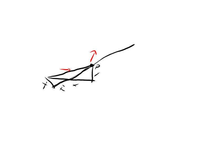

Alright, I've realized that this is actually a lot harder than I thought. So, now I have the line so I can treat the problem as just a single body deflecting off a line. The problem is that all of my information is in x-y coordinates, and I can assume that the line will be slanted, so the vector that describes the motion of this body as it approaches my line is in the wrong coordinate system. I can't break it up into x and y components in the coordinate plane of the line that I am using, or at least I'm not sure how.
I uploaded a picture to describe what I mean. (Sorry about the quality- I don't have a scanner) The information that I have is X and Y, but the information that I need is X' and Y' if the line through point p is the line I am deflecting off of. I'm sure that there is a simple trigonometry trick to find this information, but I don't know where to start.
Anyway, thanks for your help.

You need to calculate how far apart the circles are (distance from (x1,y1) to (x2,y2)). When that distance is equal to 2R, you have a collision and must figure out how the velocities change. The contact point (x',y') is just the midpoint of the line segment from center to center (average of x coords, average of y coords).
I think that "deflecting" off the common tangent line is a poor idea. In reality, much depends on the relative velocities of the objects. A better approach would be to figure out the momentum of each along the direction joining the centers and do a conservation of momentum and conservation of energy calc (or lose a few % if you wish) to determine the change in momentum in that direction. No change in the perpendicular direction. I don't think the computer time consumed in that calc will be significant.
Yeah, I figured out how to check for when a collision is happening (actually, the bodies have variable radius, so it's when r1+r2>distance) and I figured out how to find the contact point (I'm using similar triangles).
Anyway, I'm not sure I understand what you are suggesting. So, at the point of collision both bodies deflect so that the portion of their momentum along the line connecting the centers is reversed, and both momentum and energy are conserved?

A's v is at angle invTan(2/1) = 63.4 degrees counterclockwise from x direction
B's v is at 116.6 degrees counterclockwise
Unfortunately these angles don't always work out directly with inverse tan. For the B one , I had to add 180 degrees. You'll have to test a variety of directions and come up with a set of rules to adjust them.
A's momentum in the direction of slope= 3 (angle 71.6) is 56.19*cos(71.6-63.4) = 55.6.
B's momentum in that direction = 18.9*cos(116.6-71.6) = 13.4
Now using 1 instead of A, 2 instead of B
Conservation of momentum for the collision says m*v + m*v = m1*v1 + m2*v2
55.6 + 13.4 = 25.13*v1 + 4.23*v2 [1]
Conservation of energy says mv² + mv² = m*v1² + m2*v2²
125.6 + 84.4 = 25.13*v1² + 4.23*v2² [2]
Solve [1] for v2: v2 = 16.3 - 5.94v1
and sub in [2]: 210 = 25.13*v1² = 4.23(16.3 - 5.94v1)²
Quadratic solution: v1 = 27.6 or 0.328
sub in [1] to get: v2 = -148 or 14.4
B was originally going forward on the collision line, and was hit from behind, so it must continue going forward and the first solution is unreasonable. Conclude
A's speed after the collision is .328, B's is 14.4 along the collision line.
A's velocity perpendicular to the collision line was and is 2.24*sin(90-63.4) = 1
B's velocity perpendicular to the collision line was and is 4.47*sin(90-45) = -3.16
(I had to use my diagram to get the sign on B so some rule will be needed in the program for these two calcs)
A is (.328, 1), B = (14.4, -3.16) in the collision direction coordinates
A is (1.05, 71.8 degrees), B is (14.7 at -12.4 degrees)
Now we have to translate these back to the x,y coordinates.
A = 1.05 at 71.8-71.6 = 1.05 at 0.2 degrees, B = 14.7 at 71.6+12.4 = 14.7 at 84 degees.
Oh, dear, I have to for supper. And I realize this is way too complicated to be done correctly. Better to program it with some functions for rotating coordinates.
