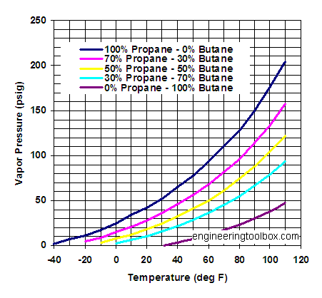

You probably don't have propane but a blend of propane and butane.
Butane gas is sold bottled as a fuel for cooking and camping. When blended with propane and other hydrocarbons, it is referred to commercially as LPG, for liquified petroleum gas.
http://en.wikipedia.org/wiki/Butane

I think it makes a lot of sense that the propane gas is a mix of propane and butane. In the last 20 years, the propane must had escape leaving the butane. That could be the reason why I got flame but it was very weak before.
