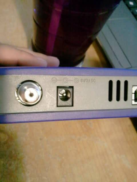

Anyhow, I have an old piece of video capture hardware, but the problem is I am missing the power plug thingamabobber :(. SADFACE.
And by that, I mean...
Now, I have a 5-12V adjustable power supply (cost me like $150 and only used it like once, be jealous!) that I can use for the power source, but how in the world can I connect it to that lil son of a witch? I've recently discovered that despite the fact that I swear every single device in the universe has its own separate plug and connector, apparently this is not true and there are only like 10 different standard adapters?

It's called a coaxial dc power plug.
Do you have the power supply and adapters in the photo? If so, just pick the one that fits the hole and be sure to configure it for positive tiip (I think I read that right in your first photo, but double-check that).
If you just have some other power supply, they you'll need to take your video thing to Radio Shack or similar place, and have the helpful sales person assist you in finding the right size. It has to have the right ID and OD both in order to fit. Then you have to wire it up with the right polarity.

No, I just grabbed that image off the net so that people knew what I was talking about. The "helpful" people at radioshack seem to get stupider and stupider and I plan on dropping by my university, grabbing a micrometer, and just measuring the power plug and determining the correct one that way. I'll also get them to fit some just to be sure... *sigh*... despite my hatred of asking them. The polarity is marked on the device, the photo just doesn't have the detail so that you can see it :).

Be very careful about this.
There are two standards with these plugs.
On your photo the centre pin is marked as plus (+).
The other standard is, of course, with the centre pin minus (-).
Make sure any replacement suupply you use is connected the correct way round.

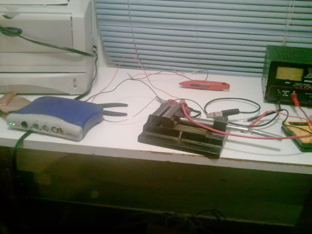

It worked <3 HAPPYFACE
And I barely killed myself :D
