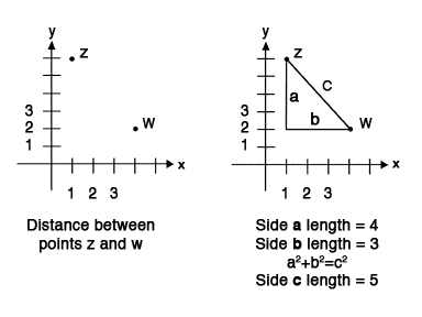

This is just the Pythagorean Theorem (which I'm assuming you're probably familiar with).
In 2-dimensional space, the distance between two points is given by a 2-dimensional version of the Pythagorean Theorem:
If there are two points, (x1,y1) and (x2,y2), and we define Δx=x2-x1 and Δy=y2-y1, then the distance between the two points (which we'll call d) is given by:
[tex]d^2=(\Delta x)^2+(\Delta y)^2[/tex]Similarly, in 3-D space the distance between two points is given by a 3-D version of the Theorem:
If we have two points, (x1,y1,z1) and (x2,y2,z2), then the distance between the two points is given by:
[tex]d^2=(\Delta x)^2+(\Delta y)^2+(\Delta z)^2[/tex]If we have two events in 4-D spacetime, (t1,x1,y1,z1) and (t2,x2,y2,z2), then the interval between these two events (which we'll call s) is given by:
[tex]s^2=-(c\Delta t)^2+(\Delta x)^2+(\Delta y)^2+(\Delta z)^2[/tex]

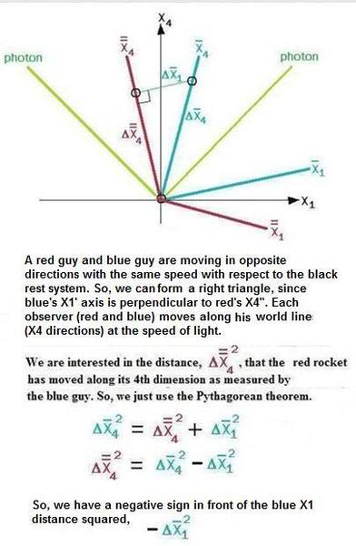

Hey elfmotat,
I had learned about c with light clocks and Pythagorean Theorem. That changed my persepctive the most, understanding what speed is. From there I went to spacetime diagrams. somewhere inbetween I forgot (neglected the importance) it is still triangles that are used in simple spacetime diagrams. Said differently, I back tracked a little :smile:
I understand the concepts of spacetime in SR (upto intervals), but not at a fundamental level. I had an oversight, regarding observations of distance, velocity ect, being triangulation.
With dimensions as the "fixed baseline", the observation being the hypotenuse. (i think that is how it is).
Which makes sense in that those "fixed" baselines (dimensions) are, for lack of a better word, effected by motion. Measurements of (along) those dimensions are in turn effected, yielding different calculated values for the hypotenuse (observation).
To perform measurements for an observation, regardless of relative motion, the observer "sets up" the "fixed" baseline (dimensions) at right angles to each other, so the hypotenuse can be calculated. Is that right? ( i hope so, i like thinking of it this way)
I really like that 3D image showing triangulating. I am going to spend some time trying to understand that. From the perspective above (triangulating), the way the time coordinate is treated still eludes me (can't picture it). It maybe I am just not familiar enough with spacetime diagrams yet.
Right now, it looks like time is negative in that equation simply because once time is equated to length the last part of the relationship is it is opposite. Time of course is not length (and not measured the same), if I'm allowed to say it is equal to but opposite of length, then it looks like once the units are the same (equal), the only missing part of the relationship is it must be opposite. I hope that's not too goofy :smile:
I wonder if hypotenuse to SR is = curves to GR.

moatasim23, here is a little different slant on how you could get that negative sign. I've used a space-time sketch in a way that allows you to start with the Pythagorean theorem, then solve for a distance. The blue guy can compute the distance red has traveled along red's X4 world line, but blue must now use a negative sign as shown in the derivation.
One way of looking at it in this context, is that you are not computing the distance for the hypotenuse of a right triangle, but rather the distance for one leg of a right triangle.
