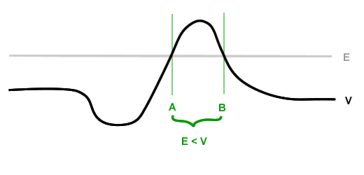

I drew myself a random potential to test if I could qualitatively deduce (the real part of) an unbounded wave function. Could someone give their opinion on it?
The random potential is as follows: the dark line indicates the potential, the grey line is the energy level of the psi function that will be drawn. The green lines, marked A and B, denote the section where E < V (and hence where psi will be exponential)

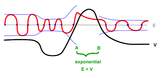

To draw Re(psi), we use that in the region where E > V:
[itex]\left\{ \begin{array}{ll} \textrm{freq} &\propto \sqrt{E-V} \\<br /> \textrm{ampl} &\propto \sqrt{|\psi|^2} \propto \frac{1}{\sqrt{ p_\textrm{classical} }} \propto \frac{1}{\sqrt[4]{E-V}} \quad \textrm{(cf. WKB approximation)}<br /> \end{array} \right.[/itex]
Using this we draw the points indicating the (local) wavelength (blue dots) and the amplitude (blue lines), both only for where there is oscillatory motion (i.e. E > V). The way the exponential is chosen indicates that it is somehow "a particle/wave coming for the left", if that is not too vague. Then [itex]Re(\psi)[/itex] (in red) is simply drawn using the blue construction:
