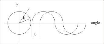

What is the theoretical definition of the phase shift?
Phase
Phase applies to the time relationship between two wave forms which are both repetitions of some basic shape over a unit period T.
These waveforms do not have to have the same shape -- but to have a constant phase -- or time relation they must have either the same frequency ( cycles (of the shape) per second OR be in an integer relation.
The simplest situation is two sinewaves of the SAME frequency but which are shifted with respect to each other in time, after shifting by one wavelength they will again be in phase -- so phase 0 to 2.pi is equivalent to one basic period T.
This definition can perhaps be best seen with a rotating vector or rod
--- if I take a rod fixed at one end and rotate it in a circle -- then if I plot the vertical (y) height against the angle (x) in a graph I will generate a sinewave.
But I can do the same with a second rod of equal or different length and generate a second sinewave .
If now I rotate them both togeter -- BUT at different starting angles
then they both generate sinewaves but are clearly shifted along the (x) axis
by some angle (0-2.pi) which IS the phase.
in maths we say v1 = A. sine (w.t) where w = 2.pi.f f=Hertz
v2 = B sine (w.t + b) t = time
the phase difference is b ( a constant )
from this it can be seen that if b=2.pi there is no difference in the time relation.
