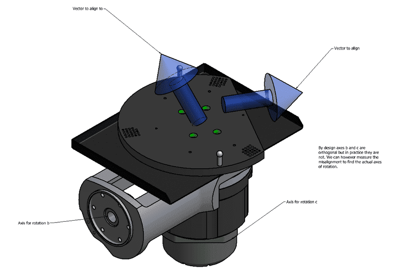

Hello,
Background:
We have a machine with two rotational axes (b,c) attached to each other. By design the B axis is rotating about the Y-axis and the c-axis is attached on top of the b axis.
Ideally the axes are orthogonal but in practice they are not. However we can measure the directions of the axes. Hence we have the axes of rotations described as two vectors.
The target is to align an arbitrary vector that is attached to the c-axis of rotation to a vector that is described in the global coordinates by changing the rotation angle of the b and c axis. We can construct the full rotation matrix but how do we find the angles b and c that aligns the vectors. From CAD we can see that there are multiple solutions.0
We can find numerous examples on how to get one angle and one axis of rotation from a rotation matrix. We can also find a lot of examples on how to split the transform into three Euler angles.
We know that the problem is possible to solve numerically but is there a closed form solution?

Thanks for the answer that would give us one axis of rotation and the corresponding angle. Our hardware constrains us to rotation about b and c and hence we need to find those two angles.
Is there a way to "split" the rotation calculated by the method you suggest into rotations b and c?

We have gotten about that far. y=Rb.Rc.x
  • Where x and y are known, the vector to align and the targetvector
  • Rb is a matrix with only the angle b unknown, the axis of rotation is known
  • Rc is a matrix with only the angle c unknown, the axis of rotation is known
We can as you say calculate a transformation R with a rotation axis, the cross product between the vectors and find the angle acos(dotproduct)
The problem is to find angles b and c given that.
I guess the question really is how hard this is, we are intermediate skill at best. If this leads to complicated calculations we will just go for a numerical solution straight away.

We tried the numerical approach and validated it against the CAD model. it seems to work fine. See below for the Maxima code we used. Thanks for the help.
