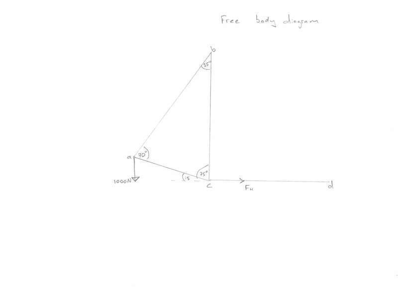

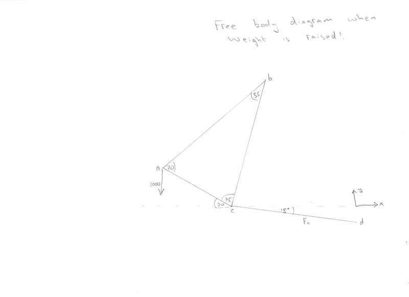

Cool, unfortunately I am still struggling. I have drawn a free body diagram and attempted to solve the problem but I am getting a value for Fh of over 3000N for a weight of 1000N on the machine. I have feeling I am goin wrong somewhere. When Does this seem large or strange?
I have attached the free body diagram of the weight before its lifted and after its lifted and at its max point.

So you have a horizontal force of 3000 N predicted given your second attachment? What angle A are you using between ab and vertical?
Also, why do you have a 15 degree angle between cd and horizontal?
Am i right in saying the following looking at the basic free body diagram?
Fac = 1000/sin 15 =3863N ?
Fh = Cos15 * Fac = 3732 ?
I'm afraid I don't know how you derived those...
Maybe this would help: Let's ignore the linkage on the exercise machine with the exception of the link between the hinge point and the weight, ab. For this linkage, ab, let's imagine a rope instead of a bar of some kind. The rope can only be under pure tension. We can't bend it or it won't be straight any more like link ab So all we have left is a weight at the end of a rope that's held up by a pin. If it dangles straight down, the tension in the rope is obviously just the value of the weight.
Now let's see if we can derive the horizontal force required to push this weight off to the side so instead of hanging vertically, the rope is rotated out to the side by some angle A (as I've marked in the attachment above). So the rope makes an angle A from a vertical line. Can you figure out what horizontal force is required to produce some given angle A and the resulting tension in the rope?
Yes that makes sense. So at the start it will require very little force to start the motion from static and this will increase significantly as the angle increases?
Correct.
