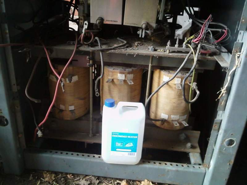

I need a 10-15 : 1 step-down transformer for an electrolysis project. It needs to be capable of about 150A. I have an old ex-military transformer/rectifier, but it outputs 200A at upto 230V DC. It has a humungous transformer in it , and some banks of BIG diodes, so if I get a variac from ebay that will handle 0-240V ac at about 15-20A, and feed the output of that into the transformer, I'm thinking I should get 0-24V at 150A no prob. Obviously, the diodes and rest of it provide the most awesome DIY rectifier kit in the world. The one problem is that the transformer is 3 phase. It has inputs of 440,415 and 380 V, and outputs of 220,210 &200 V. There is also a 0 and 30V connection. There is a second 0 which has tabs for + & - 2% on either side. I guess this is for the neutral input.
Questions:
1) The transformer is in the form of 3 coils, all on the same laminated frame but with about 50mm air gap between them. The frame runs the full width top and bottom, but not down between the individual coils.
What will happen if I connect one of the 3 coils to 240V supply. Will the others, which are on the same laminated core frame, be energised and cause problems? I only need to use one of the coils.
2) I fear that the inrush current might suck the whole of the national grid into my workshop and turn the universe into a huge black hole! Could I feed the input through a 30A triac, and start with it turned off, to build it up slowly, or would the triac stand no chance?
3) If it won't work well in its 3 phase form, would it be ok to cut the frame between the coils with a Stihl saw, and use the coils separately?

Can you post a picture?

I've uploaded a couple of pics, ( I think! ). For scale, there is a 5L DI water bottle. I used to scrap main frame computer equipment for a living, so I've seen some pretty heavy duty power supplies, but the scale of this is quite different. I wonder how big it gets before they need to be oil cooled!
PS point taken about feeling the coils up, it would be a shame to fry the old girl.

Be aware that the magnetic flux flows around a closed loop in the iron, just as Kirchoff's current makes a loop in the copper.
Now look at the center leg of your transformer.
When flux is UP in that leg it is DOWN in the other two. Right hand rule and all...
So if you were to wire them in parallel you'd be trying to push flux UP in all three at once.
Since flux couldn't then make a closed loop your current would go sky high.
To get a feel for this, experiment with your core.
Apply maybe twenty volts to center winding.
Measure outside ones and see if you don't get ten volts each - that's because flux from center leg divided equally between the outside legs for its return trip.
Now place one turn of big wire, like #10, around either outside leg. Or just short the winding.
That leg will now have ~zero volts and the other one ~twenty because the shorted turn pushed all the flux over to the other leg.
I reallly suggest you do that experiment - it will cement in your mind how a transformer works.
Measuring the current in your shorted turn will give you a good idea of the amp-turns required to push the flux through your core, a measure of its reluctance.
You could also wire all 3 phases in parallel and excite gently with your variac but monitor current and be cautious - use a fuse..

Maybe you can figure out a novel way to wire your coils and use them all, but i doubt you'll be able to do better than one at full voltage and two at half voltage.
With three phase you can use all 3 windings at full voltage because of the 120 degree angle. Walk around a triangle and you have closed a loop, the three equal sides can be thought of as vectors that add to zero..
But you can't make three vectors of equal length that are aligned 0 or 180 add to zero.

This might sound like awful butchery, but I did mention that as there is no core between the coils, it would be easy to cut the core, top and bottom in 2 places with a Stihl saw, and make 3 separate coils. Obviously, I can experiment with it in 3 phase mode first, to gain better understanding, but as there is no real advantage for me in having a 3 phase transformer, would this not be the best way to use all 3 ?
your magnetic flux must make a closed loop inside the iron
if it goes UP through iron of one coil it must come back DOWN somewhere still through iron, so dont separate those iron legs !

The three phases, each at the three 120 degree angles, will average out in the 3 legged core. The phase angle and amplitude of any phase angle is equal (and opposite for the core) to the phase angle and amplitude of the other two.
At 200A 230V L-N per phase winding, this is a 138 kVA transformer. You could use 2 windings in single phase by removing a winding leg, for a 92 kVA transformer. The 400V side would be 115A. If you wire two 400V windings in series and two 230V windings in parallel, feed 230V to the (now 800V) series winding, you would get 66.125V on the paralleled 230V winding, with a capacity to go to 400 amps. To get your 150A at 66.125V, you'll draw 43.125A from 230V.
The removed winding may be usable as a current limiting inductor.
What voltage does your electrolysis project need? Is 66.125V usable? What current limiting means is involved? Or are you depending on finding a voltage that won't draw more than 150A at the lower voltage on the load?
