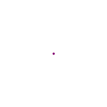

Here, I have set up a distribution of 5000 "clocks" and given them each a rapidity in the x-direction between -3 and 3, and a rapidity in the y-direction between -3 and 3. I picked out several random clocks and gave them colors. Here is the explosion from the blue-clock's perspective:
And here is the same explosion from the Yellow clock's perspective:
But the point I wanted to make was, if I had, for instance, selected rapidities in the domain of (-100,100) instead of between (-3,3) then there would hardly be any noticeable difference in the distribution for the selected clocks.
So in fact, I guess I mis-spoke, because it's not the number of clocks that makes a difference, but the width of the rapidity space.
If you'd like to see all 11 perspectives, see here
