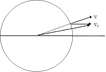

I understand the formula, I however don't understand why there is a deflection when a particle (not on the equator) travels east or west. I do understand why there is a deflection when a particle is traveling north or south.
Launching from any lattitude still provides a radial velocity component with respect to the Earth's spherical coordinate system.
I have attached a figure, which I hope is clear.

Henk said:
But why?
I understand that it deflects to the right when shot to the North. When for example a particle is shot from the equator to Norway it deflects to the right because the eastward speed of the particle is greater then that of Norway.
But why does it deflect when it travels east?
It might help to think of it this way:
When the projectile is at high altitude, it has to go further to go east that if it's at the surface because it is traveling on a larger circle.
Let's look at conservation of angular momentum.

I understand this but how does this mean that the projectile is deflected north or south. It makes sense that [tex]\omega'<\omega[/tex] because of the greater circle. But when it comes down on the ground:
angular momentum is conserved so that the projectile regains his original [tex]\omega[/tex] but that means that it is on the same latitude where it started from.
One more question: does anyone know what [tex]\omega[/tex] is of a typical projectile. What order? is it around 50 (20 circulations/s) or much more or less?
Thanks for the correction dex.
I didn't suggest that the projectile was being deflected north or south, but it is being deflected to the east or west. (Or depending on how you look at it, up and down or out and in.)
[tex]\omega=\frac{v_{tangential}}{r}[/tex]
The angular speed of the surface of the earth, or a projectile that has been launched 'straight up' is
[tex]\frac{2\pi}{86400s}[/tex]
To find the angular speed of a projectile that is launched at an angle, you need to add a term for the appropriate transverse component. Remeber that it's the rotational radius rather than the radius of a great circle that we're talking about here, so it's smaller in Alaska than in Ecuador.
Note that this is *not* the same rotational speed that you would be talking about for the magnus effect where you're talking about a spinning projectile.
