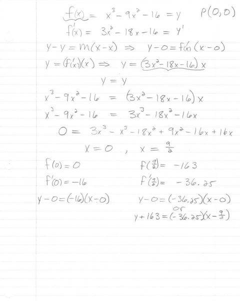

The problem I had recently was: Find the equations of the lines that pass through (0,0) and are tangent to "f(x) = x^3 - 9x^2 - 16x = y
When comparing these two problems, the process of finding the answer seems to be different, however, the question is essentially asking the same exact thing in both problems. So I must not be seeing "how" the process of solving each is actually similar or the same.
Here is the first one that I solved:

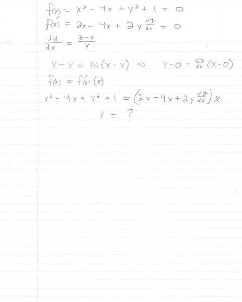

However, when I follow the same exact process for the current problem involving implicit differentiation, I get this:
In the first problem, I am supposed to be looking for the equation of a line: (y-y)=m(x-x) and it becomes f(x) = (f'(x))(x)
However, the case of implicit differentiation does not seem to want to follow the same process, which leads me to the observation that:
in the first non implicit problem, f(x) = x^3 - 9x^2 - 16x fits neatly into the left side of equation y=f'x(x)

in the implicit problem f(x) = x^2 - 4x + y^2 + 1 = 0 does not fit neatly into the left side of equation y=f'x(x)
Why does f(x) = x^2 - 4x + y^2 + 1 = 0 not fit neatly into the left side of equation y = f'x(x) ? I thought that f(x) always equals y, since the equation for a function seems to always be expressed as "f(x) = y"
Also, in the non implicit problem, f'(x) = 3x^2 - 18x - 16 seems to fit neatly into the m term of y=f'x(x)

in the implicit problem, f'(x) = 2x - 4 + 2y(dy/dx) = 0 does not fit neatly into the m term of y = f'x(x)
Why does f'(x) = 2x - 4 + 2y(dy/dx) = 0 not fit neatly in m? I thought that f'(x) was supposed to represent the slope of the tangent, thus fitting neatly into the m term (since it works that way in the non implicit problem).
Is it the fact that the equation is set equal to zero in the implicit problem while the function in the first problem is not set equal to zero? Does that have any impact on the process of solving this problem, if so, what impact does the zero have?
Is it the fact that there are x's and y's together in the implicit problem that is the factor that doesn't allow the entire f'x to fit neatly into the m term?
Why must we change the functions in order to arrive at the correct x value?
You write, repeatedly, "f(x)" while there is no such "f". y is NOT a function of x.
This was a very confusing problem as it is. But the fact that I didn't understand that if an equation is in terms of both x and y's on one side, then it can't be considered a function of the form "f(x) = y. Thus its no wonder why it does fit so neatly. I would either have to get everything in terms of x before taking the derivative...or, as an easier route, i could do some substitution to solve for x. Once I solve for x, I then need to find y. Once I have both x and y values, I can then find the slope value. Then, the equation of the line(s) can be formed.
