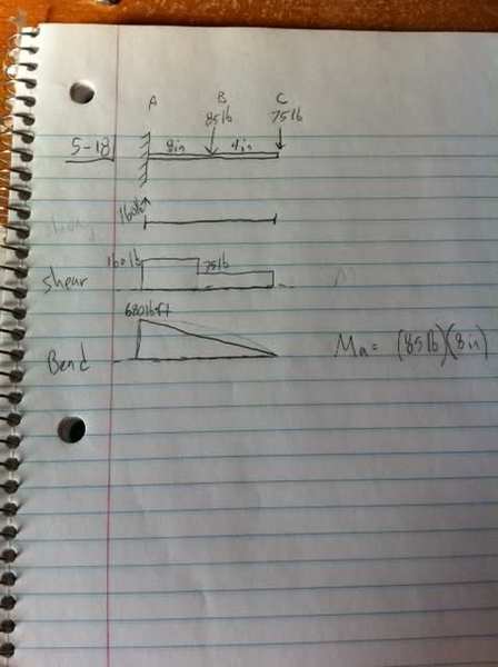

M = FD

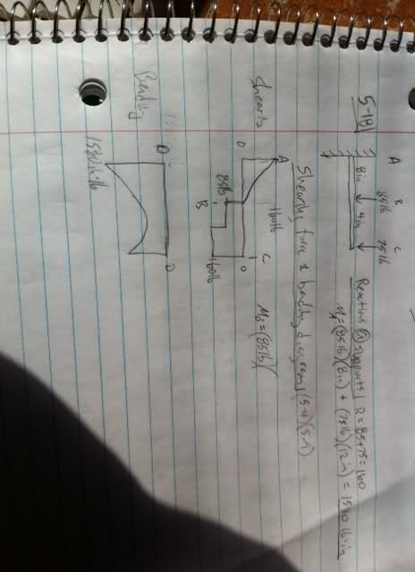

I didn't attempt to finish it since I sort of got stuck. I was looking for examples in the book for how to do this and can't seem to find. Am I even close to correct on either the shearing or bending diagram? thanks
Your loading diagram shows two point loads, yet your shear diagram shows three discontinuities. Why?

alright, so when you have a beam tacked onto a wall as in this example, is it treated the same way as though it was just sitting on a pivot on that end? thanks
an improvement I hope, still don't know how to approach the bending diagram of moments.
Your shear diagram shows a pair of steps, so there should be two different slopes evident on your bending moment diagram. I can't really tell if you tried to show that or not, but it is not very clear on your diagram. The left most slope should be quite a bit higher (magnitude) than the one of the right.
The built-in end does support a moment, unlike the pined end, and that is why the moment diagram does not go to zero on the left end. It comes out at the wall moment value.
