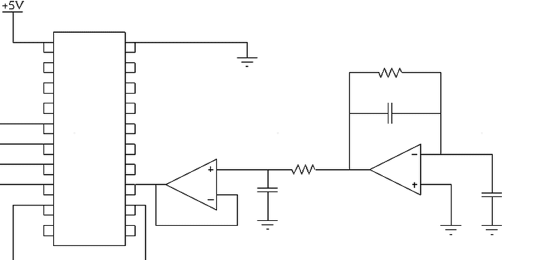

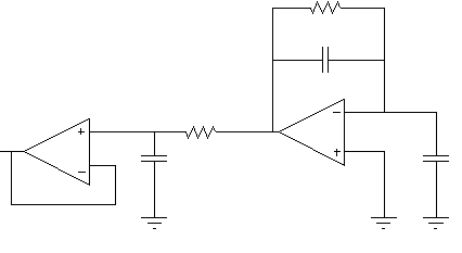

i use pipe water. n 1 more thing is the signal conditioning circuit i used is charge amp with 5Vdc. i used R2=1MΩ C2=4.7nF n RClowpass+buffer.but the ouput vlotage i get is increase for a long time n not stable if i increase water level.why?

You may be getting polarization of the water at the metal surfaces.
This can be seen as bubbles on the metal surface due to DC current passing through the solution.
You can avoid this by just applying power when you want to take a reading.
it do has bubbles.applying power?u mean drive oscillator ac?
I'm not sure what that means.
The bubbles on the surface of an electrode reduce the surface area for current to flow. So, this may be one reason that your reading is varying.
These bubbles do not form if you use AC and you can also reduce them if you use less DC current or use DC current in short bursts. Stirring tends to sweep the bubbles away too.
If you are familiar with microprocessors, you can use them to generate a DC voltage with one pin and take a voltage reading with another pin and store the value. Then remove the DC voltage.
So, you might take a reading in less than a second and display it for a minute or so, then take another reading.
This is extremely effective at avoiding polarization.

i used pic18f14k50.sorry, i m not very understand what u mean. i cannot imagine very well. can u show me the circuit diagram?

Your capacitor is not working as a capacitor, because it is in water which has a relatively low resistance.
So, you can just accept this and use it as a variable resistor.
This means that you can just put it in a DC circuit and amplify with a conventional opamp if you like.

but the capacitace is also increase for my measurement, it can't be a capacitor?
It is still a capacitor but with a low value of resistance in parallel with it.
So, you will have a lot of trouble trying to measure the capacitance while the resistance is there and varying.

so according to my circuit, i can't use Vo/Vin=Cs/Cf, how i calculate output voltage?
Your measurement is not stable since the DC current through the water is decomposing it and you are getting bubbles of gas forming on the electrodes.

so i need take it as resistive transducer. the charge amp will not working if i use charge amp? but the output voltage did increase for my measurement
Yes, it would, but it is just working on the resistance of the water.
that mean it just working on feedback resistor, Rf not Cf?

1 last question for charge amp, is charge amp really amplify output signal for dc or just a charge voltage converter?confuse to looked at the wiki as above..
