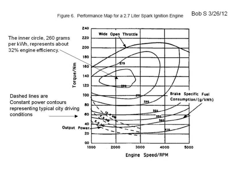

I attach a BSFC (brake specific fuel consumption) plot of a typical 2.7 liter automobile engine. Note that the peak torque output is about 200 Nm at 4000 RPM, which would be 800 Nm and 1000 RPM with a 4:1 differential.
Power = watts = torque x radians/sec = 800 x 1000 x 2π/80 = 84,000 watts = 112 HP.
A typical wheel might have a diameter of 0.7 meters, so 1000 RPM is 105 radians/sec so speed is 36.7 meters/sec = 82 MPH.
