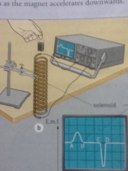

Now, here we have a magnet being dropped into a coil.
The graph of EMF against time is more of a smooth pulse...
I have two questions :
1.) Why is it not a straight line that has constant gradient that then decreases instantaneously to zero ?
2.) Why does the EMF decrease to zero ? I know its because no lines of force are cut by the coil, but I cannot see how this is the case. I'm having trouble visualising it.

This a diagram from my A Level Physics textbook.
It clearly shows a long stretch where EMF = 0. The explanation given is as follows:
there is no change in the flux linking the coil as the motion is parallel to the magnetic field.

But then why does it decrease to zero and remain at zero for so long ? (see second attachment).
Now that I think about it, it should be a smooth change over from a positive emf to a negative emf as shown in the first picture...
ohh, i thought we were talking about the first picture
ok, in the second picture there's a vertical solenoid (with no battery), and a very small magnet dropping through it
so long as the magnet is well inside the solenoid, the number of field lines being cut at any instant (the flux) is constant, irrespective of the speed
remember, the speed at which they're cut doesn't matter, what matters is the difference in the number being cut at any instant, from one instant to another :wink:

No, you're failing to see my point.
EMF = BLV
If the magnet is traveling at 0.1 m/s it will cut 3 (just a random number) coils in the solenoid.
Since its accelerating it is now at a speed of, let's say, 0.3 m/s. Therefore, in one second it will travel further than previously and hence cut MORE coils in the same time.
So why does the EMF fall to zero for so long ?
ah, no, BLv only applies when v is in the plane of the wire, ie when the plane of the wire is crossing the B field lines (as opposed to moving along them)
BLv comes from emf = d/dt (flux) = d/dt (BA) where A is area cut by the flux = d/dt (BLW) where L is length inside the B field and W is width
now if the loop is entering the B field sideways on (in its own plane), with the L sides at back and front, so that L stays the same while W increases, then dW/dt = v, and so …
emf = BLv​
see the diagram at http://hyperphysics.phy-astr.gsu.edu/hbase/electric/elevol.html#c3 (hyperphysics has the best diagrams! :approve:)
comparing your example with that diagram, your magnet, which is pointing vertically, is coming out of the page, but your wire isn't moving across the field lines, it's moving along them …
the number of dots (field lines) that your wire encloses is staying the same :wink:
Yes ! I finally understand ! Thank you Tiny Tim ! :)
