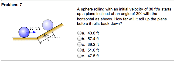

A sphere rolling with an initial velocity of 30 ft/s starts up a plane inclined at an angle of 30o with the horizontal as shown. How far will it roll up the plane before it rolls back down?

And that is not one of the answers, I assume inertia is supposed to be used somewhere but I have no idea where to plug it in because no radius of the circle is give.. Any help would be very much appreciated\

It's a sphere! Assuming this to be a case of rolling without slipping, the the total energy in the sphere is [itex]\frac{7}{10}[/itex]mv[itex]^{2}[/itex]
Here's how:
Total energy
= Translational Kinetic energy + Rotational kinetic energy
= [itex]\frac{1}{2}[/itex]mv[itex]^{2}[/itex] + [itex]\frac{1}{2}[/itex]I[itex]\omega[/itex][itex]^{2}[/itex]
(m = mass
v = velocity
I= moment of iniertia about the centre
[itex]\omega[/itex]=angular velocity about the centre
r=radius of the sphere
=[itex]\frac{1}{2}[/itex]mv[itex]^{2}[/itex] + [itex]\frac{1}{2}[/itex]([itex]\frac{2}{5}[/itex]mr[itex]^{2}[/itex])[itex]\omega[/itex][itex]^{2}[/itex]
(Because I = [itex]\frac{2}{5}[/itex]mr[itex]^{2}[/itex], for a sphere)
=[itex]\frac{1}{2}[/itex]mv[itex]^{2}[/itex] + [itex]\frac{1}{2}[/itex]([itex]\frac{2}{5}[/itex]mr[itex]^{2}[/itex])([itex]\frac{v}{r}[/itex])[itex]^{2}[/itex]
(Because v = [itex]\omega[/itex]r, for rolling without slipping)
Solving this gives [itex]\frac{7}{10}[/itex]mv[itex]^{2}[/itex].
Try putting that and you should get an answer.
Ugh, I'm an idiot haha. Thank you! I got it now!
