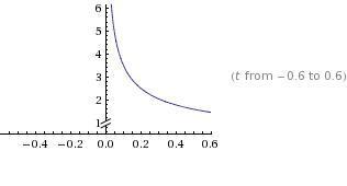

Femme_physics said:
Is my graph above correct?
If it is V(t), it does not look like the real one. Try to plot V(t) you have got.Or see picture.

Thanks :)And yes, your graph makes sense but I thought that if V is going downwards I use a minus sign, but on second thought minus is a property of how acceleration behaves on the velocity, not velocity itself. Maybe it would be wiser to leave the leading direction of velocity (down in this case) as plus, always?
Yes, that rocket can not turn upward, can it? So let the velocity be plus.
The 60 m/s for initial value meant downward velocity, into the water, not out of it.
The acceleration was negative with respect to the velocity (deceleration).
