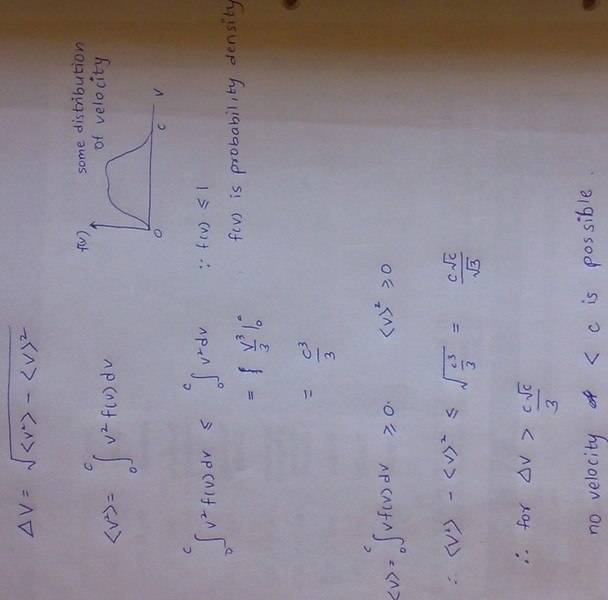

@grindfreak:i wanted to conclude something about v from Δv.your observation is right but i think if Δv is greater than a particular value there is no possible v below c.i have attached a reasoning.

The uncertainity relates position with momenta, you just have to use the relativistic expression for momenta in order to get the velocity. With the data you have provided that will be about 0,97c. This obviously confirms that the relativistic expression must be used.
At first we get Δp and then Δv is derived from Δp.
Of course if the space where the electron is confined is so small that the electron total energy becomes much greater that it's rest energy, others effects like pair electron positron creation may occur but that's another matter more complicated
Although I am not currently skilled in QFT, I do know that one can have infinite uncertainty of a variable (meaning we are approaching infinite precision for the other). In my mind this does not mean that the particle is moving with a relativistic speed, it just means that the uncertainty is of the very high order of 1010, and since this is greater than the speed of light, we have no real way of measuring its velocity. Basically as Δx -> 0, Δp ->∞, since their product is greater than or equal to hcross/2.

Δp ->∞ means that v -> c. See any basic relativity textbook.
In what world does Δp ->∞ mean that v->c? Δp = √(<p2> - <p>2) where <p> = ∫ψ*pψdp for a wave function in the p basis as seen in any basic quantum physics text. This is the standard deviation, it has nothing to do with the momentum or the velocity approaching a certain value.
You are using a correct definition of Δp but an infinite standard deviation on the momenta means that the momenta is absolutelly undefined and therefore the most probable speeds are those nearer to the speed of light. That's because the "density of states" of the momenta in function of speed is greater for velocities near to c. In the limit v --> c the "density of states" grows infinite.
If a particle is trapped on a box such small as the one you proposed, then the uncertinity in its momenta will be great and therefore speeds a almost as c are probable. Of coure it's also possible to found the particle v = 0.
