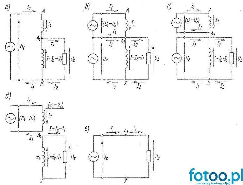

[STRIKE]what kind of auto transformer, post a connection schematic.[/STRIKE]
EDIT: [STRIKE]Is it wounded on toroidal core or polyphase column core ? I don't know what is Your understanding of this at all. At which level I should start explaining ? Total basics ?[/STRIKE]
I'll try one more time.

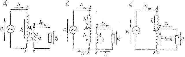

Below You have schematic how to 'make' autotransformer from trasnformer.
As You can see (a), this device works basing on Faraday's law of electromagnetic induction. Ampereturns of primary winding (A-X) create a flux in core (there is a core on which both windings are wounded). Current and voltage are transferred to secondary circuit totally wireless.
On (b) we can see, that it is possible to connect both windings at points, where their potentials (voltages) are exacly the same at all times (X-x and A1-a). It won't change the current flow or voltage distribution. It still works basing on Faraday's law but we have established a galvanic connection between primary and secondary circuits.
Now (c), if we'll replace primary and secondary windings with one (single inductor wounded on toroidal core in ex.) with the same turn ratio we can see that power is transferred via two ways:
1) Electric conduction - both windings are connected. Since there is voltage difference the current will flow from source to output.
2) Electromagnetic induction. We have electromagntic coupling. Current in primary (A-a1) is opposite to current in secondary (A1-x). Electromagnetic coupling means there is voltage induced and current will flow. Look at the current flow direction. Currents from primary and secondary part of THE SAME INDUCTOR adds in point a or A1 and flow to output.
In small 'lab' AT You can change the turn ratio. Output is connected to moving contact joint that can be replaced changing turn ratio. Turn ratios of windings are:
1) primray N1-N2
2) secondary N2
Voltage change can be calculated from: V1/V2 ~= N1/N2
In big power AT's it's different. We have no moving contact joints but regulation winding treated electromagnetically just as integral part of one of the windings. With use of tap changer we change turn ratio, like I've said few post's above.
Does this need any more explanation ?

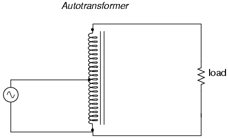

I have one last question about auto-transformers, how does the auto-transformer step-up voltage?
Below is a diagram of a single winding auto-transformer in step-up mode:
Could it be because of this:

P1 = P2
V1*I1 = V2*I2
A transformer winding has 110v across T turns, now many volts across 2T turns? :smile:
Observe that bottom part of core carries both input current AND output current
N O got it - volts per turn is the flux.
Search on "Variac" - a brand of adjustable step down autotransformers.
Would the correct answer be 220V?
Bararontok said:
Would the correct answer be 220V? ✔ [/size][/color]
Don't try to extend this thinking to a potentiometer, though. The autotransformer has the underlying principles of transformer action to make it work. A potentiometer is just two resistances, so a potentiometer can never "step up" a voltage, even though the schematics may bear a superficial resemblance.
This is correct because a potentiometer is made up of a resistive material while an auto-transformer uses an inductor.
