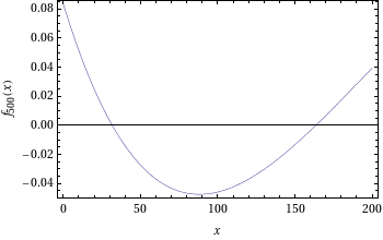

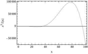

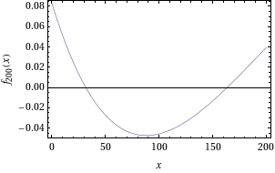

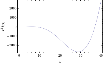

The point [itex]x = 0[/itex] is singular for the equation:
[tex] x^3 y^{IV} = -c y[/tex]
because it implies
[tex] y(0) = y'(0) = y''(0) = 0[/tex]
as can easily be verified by differentiating twice and substituting [itex]x = 0[/itex]. This means we cannot give arbitrary initial conditions to find the 4 conditions in a general solution. We can only choose one arbitrary constant corresponding to the freedom in choosing [itex]y'''(0)[/itex]. Thus, we would find a singular solution.
Taking nth derivative and setting [itex]x = 0[/itex], we get:
[tex] 6 \, \left( \begin{array}{c}n \\ 3\end{array} \right) \, y^{(n + 1)}(0) = -c y^{(n)}(0), \ n \ge 3[/tex]
This first order recursion allows us to write down a Taylor series solution. Take [itex]c_{n} = y^{(n + 3)}/(n + 3)![/itex]. We get:
[tex] 6 \frac{(n + 3)!}{3! \, n!} (n + 4)! c_{n + 1} = -c (n + 3)! c_{n}, \ n \ ge 0[/tex]
[tex] c_{n+1} = -c \frac{c_{n}}{(n + 1) (n + 2) (n + 3)}, \ n \ge 0[/tex]
The solution of this recursion is:
[tex] c_{n} = c_{0} \frac{0! \, 1! \, 2! \, (-c)^{n}}{n! \, (n + 1)! \, (n + 2)!}[/tex]
The series solution is
[tex] y(x) = K \, x^3 \, f(c \, x)[/tex]
where:
[tex] f(x) = \sum_{n = 0}^{\infty}{\frac{(-x)^{n}}{n! \, (n + 1)! \, (n + 2)!}}[/tex]
Here are 3 plots of [itex]x^3 \, f(x)[/itex]. The sum should converge rapidly. I calculated the sum of the first 201 terms by Mathematica. The function is oscillatory with ever increasing amplitude. Notice the change of vertical scale:

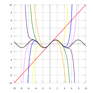

Yes, you can. For example:
As you increase the number of terms in the Taylor series for [itex]\sin x[/itex], the domain where the truncated series approximates the true function increases, eventually encompassing the zeros of the function.
The oscillatory nature of the function is seen from the alternating sign of successive terms in the series (see Bessel function, for another example).

Here is the partial sum of the first 201, and the first 501 terms, respectively for f(x):
As you can see, they are indistinguishable in the much larger region [itex]x \in [0, 200][/itex]. Also, you can see the function still changes sign.
