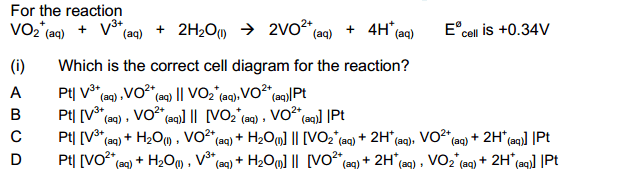

I always thought you put the electrolyte of one half cell on one side and the other electrolyte on the other side
The answer given is C.
But this includes VO2+ which is not in the initial eqn on the RHS?
Try to split the reaction into half reactions.
borek said:
try to split the reaction into half reactions.
V3+ + H2O = VO2+ + 2H+
VO2+ + H2o = VO2+ + 2h+
They are not balanced yet (you ignored electrons), but you are on the right track.
Do you see why C?
Do you see why C?
Well V3+ is oxidised (reducing agent) and VO2+ is reduced (oxidising agent).
I think you are supposed to put the stronger reducing agent on the left side?
Isn't it what they did?
...of course...I think I just get confused between VO2+ and VO2+.
...I guess though this will help me in exams as I will be more aware of what is going on...thanks for helping me :)
