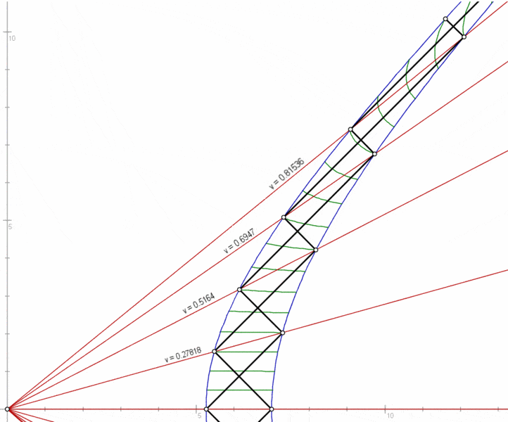

It does track. See the attached chart showing two rockets with Born rigid acceleration. Each time signals (black diagonal lines) are emitted simultaneously in one MCIRF, they are received simultaneously in a subsequent MCIRF. In the chart green curves represent equal proper time for the rocket clocks, red lines represent lines of equal velocity relative to the LF (or subsequent MCIRFs) and the blue lines represent the worldlines of the rockets in the LF. Note the constant nature of the redshift. Signals sent every 3 ticks from the rear rocket are received every 4 ticks by the leading rocket.

It does work for other velocities. Have another look at the posted chart. The rear rocket sends signals every 3 ticks and the front rocket receives those signals every 4 ticks, consistently even as the relative rocket velocities constantly change over time. If we speed up the rear clock by a factor of 4/3 then the front observer will see the rear clock ticking at the same rate as his own clock for all time.

Again, if you look at the attached chart you see that the front rocket sends a signal when the rocket velocities in the LF are approximately 0.69c and the rear rocket receives that signal when the rocket velocities are approximately 0.81c in the LF and there are no problems with the rear rocket overtaking the front rocket. (Another curious aspect is that a light signal sent from left of the origin can never catch up with the accelerating rockets, even though they never attain light speed. That should bake your noodle! ).
