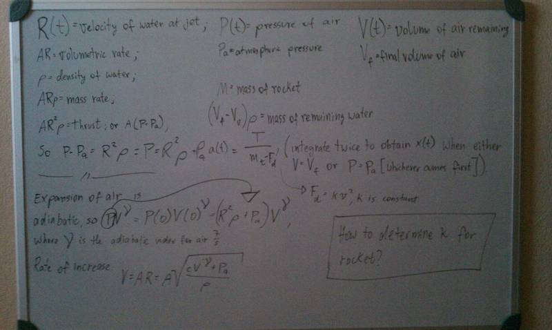

I'm sorry for extending this thread for so long, but I want to understand this.
Okay, well, I never really used spreadsheet for this so I am stuck.
I made the A column from time 0 to 10 in .2 intervals.
And now what?
Attached are the formulae and variables I got from you.
To clear up,
A is the cross-sectional area [itex]\pi[/itex]r2
R is [itex]\sqrt{\frac{cV^{-\gamma}+ Pa}{ρ}}[/itex], what is c?
EDIT: Is the expression ARρ actually [itex]\dot{m}[/itex] = [itex]\int[/itex][itex]\int_{A}[/itex] j[itex]_{m}[/itex]dA where j[itex]_{m}[/itex] is the mass flux and it's a double integral since the surface is curved and not planar?
EDIT 2: Is Torricelli's law useful in this case?

Whoops - I made a mistake here:
should be - Pa:
R is [itex]\sqrt{\frac{cV^{-\gamma}- Pa}{ρ}}[/itex]
c = P(0).V(0)γ
I didn't understand the question about mass flux and double integral. Yes, ARρ is the mass flux through the jet. What curved surface are you thinking of?
Torricelli's law is not relevant, but the more general form, Bernoulli's principle, is.
In fact, it suggests I have another mistake. Where I have
P - Pa = R2
Bernoulli says I'm missing a factor of 2:
2(P - Pa) = R2
I can't see where I went wrong, but deriving it another way does indeed bring in that factor of 2.
As someone else posted, forget about air resistance. It won't matter at the speeds you'll get.
In the attached photo, I see one error in transcription. You may have misinterpreted this:
Rate of increase of V = A.R
I mean that dV/dt = A.R.
One more error: left out -g in the acceleration.
Please see attached spreadsheet. I had to cut it off after relatively few rows to fit in the forum limit, but you can just copy the last row down to cover a longer time period. All units MKS.

The first steps are a bit rough, and the volume of the air should be larger to keep the high thrust longer.
Here a modified version - I fixed the total volume to 1 liter, but that is arbitrary. On the right side I added the analytic approach - as you can see, the value is too high, but it is not completely off.

You can get a handle on the accuracy of the spreadsheet by making the time steps finer until it doesn't change the result much.
mfb is right that the steps were much too coarse for the early stages. I've change the time step formula in my copy to e.g.:
A5 = A4*1.01 + 0.0001
That way you get a much finer step initially, but the steps broaden as things settle down. Another approach would be to make the step size inversely proportional to the acceleration caclulated in the preceding row.
Determining the accuracy of an analytic solution, given that it necessarily simplifies some equations to be able to solve them, is much harder. OTOH, if it is at all accurate then you could differentiate wrt settings (like initial airspace) to see the effect of changing them.
Of course, you could do the same or better programmatically. Turn the spreadsheet into a C program and wrap it in a loop which hunts for max height.
