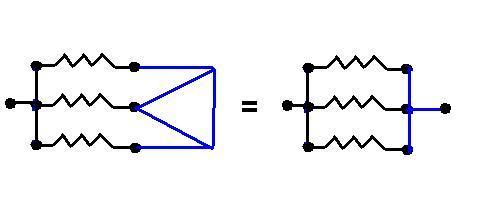

If points in an electric circuit are connected with wires (of zero resistance) these wires can be replaced by a single node. Points of equal potential always can be connected, it does not alter anything in the circuit.
ehild

I know how to do it by applying Kirchoff's law but I am looking forward to solve it by the method of connecting points of equal potentials . I understand that the points with equal potentials can be connected without affecting the circuit but I just wanted a more clear image of how this has been done . I mean how did they connect the three points , did they make all the point one single point ? :rolleyes:
See the figure in #3. They make it a single point at the end.
ehild

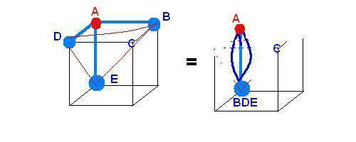

@echild Thanks but can you please show me the picture of how the three points are made one in the cubical network . Thanks
Also in the same cubical network If I were to finto resistance between points B and D , why will the current bit flow through the branches CG AND AE
You can distort the square, nothing happens when you do not change the connection between the nodes. Just press the dots representing the corners B,D,E together. The wires which were the edges, will bend but their resistance does not change.
ehild

alright now I know how they can be connected thank you sooo much ! but how are the remaining 6 resistors in parallel ?
Also can I solve for equivalent resistance between any other two points using the same approach?
