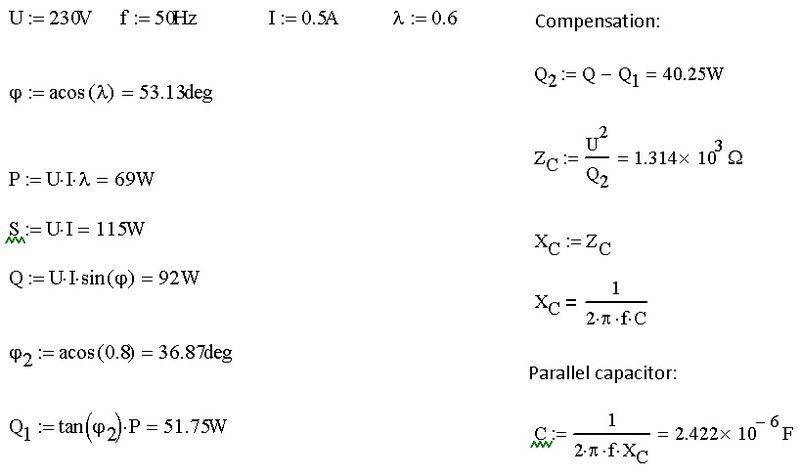

If a a circuit is too inductive, and has a power factor of 0.6, how would i find a capacitor in series or parallel that would give a power factor of 0.8?
I think that i could do it with 3 equations and 3 unkowns like this:
1: Q=XL*I^2
Z=X*I^2
2: tan(P/Q)=[itex]\varphi[/itex]
tan(P/Z)=Y
3: cos(Y)=0.8
Then solve for X and Y and Z?
Please help.

I found out. See pic :)

PFC.jpg in #3
No. S is apparent, Q is reactive and P is the effective
EVriderDK said:
PFC.jpg in #3
Here's the figure !
EV,
A power triangle diagram would have been nice. I just noticed, the page you referenced gives the solution you want. C = 2.422 uf in the lower right corner. What else do you want to know?

Nothing. As i wrote, i found out :)
SammyS,
Call it a figure if you wish. That is a list of values for a bunch of undefined quantities. It wasn't until he explained which quantities defined the power triangle that I understood how everything was related, and the answer was already present.
Ratch

Sorry, thourght P, Q and S was standard.
