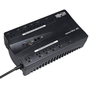

I have an air turbine, and it's critical that the motor speed be precisely regulated.
It's very voltage-sensitive, so the fluctuations in the line voltage between 120-126 A make the motor speed too variable.
How can it be regulated?
A UPS might work. But it would have to output voltage accurate within +/- 1%. THere's a rheostat on the motor, so the UPS could just regulate up, say, so it wouldn't be necessary to have both a step-up and step-down transformer. The motor uses 1-2 A at the normal speed. It uses max 9 A, but I never use it at that speed. I don't know, if you get a voltage regulator that's rated for a certain current, and more current goes through it, if it damages the voltage regulator, or it just can't regulate the voltage right.
It also needs battery backup for when the power fails.
Can anyone point me to such a UPS?
It would be great if the input voltage could be regulated by the actual airflow. The air turbine is powering an airline respirator, the airflow is 4-5 CFM through a hose maybe 3/4" inner diameter, with garden hose fittings. If anyone can help with that I'd appreciate it.

Hi Lark. You are going about it the wrong way, wanting to tightly fix the voltage. This means you are placing blind faith in the motor maintaining a constant angular velocity for a fixed supply voltage. What happens when the motor ages, or atmospheric pressure changes, or thermal effects show up?
Much better to use a feedback arrangement and try to maintain a constant airflow. But measuring airflow accurately may be difficult, easier is to measure speed of rotation and alter the voltage to the motor in an effort to maintain a fixed angular velocity. You can accurately sense the speed by sensing the passage of a pattern of dots around the shaft. Or maybe there is somewhere to measure pressure, and try to maintain that at a constant level?
Sorry, I don't have circuits in mind. Just pointing out what I reckon you should be looking out for.
If you're lucky, others may have some recommendations. Good luck!

There's a device called "Ferroresonant Transformer" that delivers nearly constant voltage, typically 3% Δout for ~15%Δin.
A company named Sola invented them in 1930's and they are still the industry workhorse. I see they now advertise 1% output regulation in their CVS series...
http://www.solahevidutysales.com/cvs_hardwired_series_power_conditioner.htm
They are heavy, expensive, bulky and run hot but they last forever. Because of their longevity they are fairly common on the surplus market. Occasionally I see one in my scrap metal salvage yard. About all that ever goes wrong is the internal capacitor fails and it's an inexpensive part.
Their CVS series has harmonic suppression, but for just running a motor you wouldn't need that.

hmmm i couldn't find a published number for regulation of these little Tripp-Lite UPS's..
perhaps a friendly store would let you try one
Office Depot sells them
Tripp Lite INTERNET750U 750VA 450W UPS
That UPS has a capacity in the order of minutes, according to the spec. This is because it's specifically designed for computer use - total continuity of supply when the mains fail, to allow clean shut down. If the motor actually stopped, would it matter, even for a minute or so? An audible alarm would be cheap enough and an inverter could be manually switched in. Alternatively, a clunky, non synchronous, automatic switch box would be easy to provide, even. If the motor runs adequately at less than 2A, a simple 24V - 120V inverter, along with a couple of 80Ahr 12V batteries would give hours of cover. I am sure that would cost less and be more suitable than a UPS which has been designed for a different, specific, application.
For regulation, a bench test would be essential. Too many unknowns, at present. A CV transformer would certainly be a reliable solution if it worked. I can't imagine that motor would be an embarrassing load - especially if wound up slowly.
