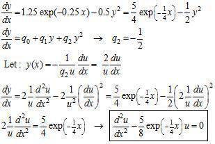

Hi !
there is no need to do again the proof of the change of function y(x) -> u(x) which is shown by Wikipedia.
Just apply it : y(x)=-u'/(q2*u) : see attachment.

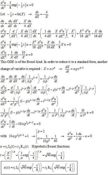

Obviously, a change of variable X=exp(-x/4) allows to simplify the ODE (see attachment).
This leads to a new ODE of the Bessel kind, but not on a standard form.
Another change of variable allows to reduce the ODE to a standard Bessel equation.
This leads to the solutions u(x). See attachment.

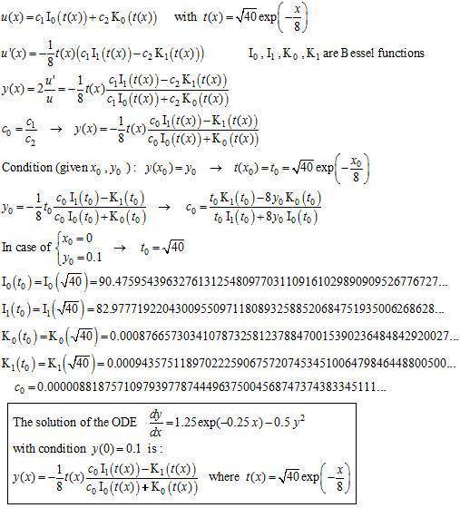

Then, you will have to express the derivative u'(x) and the final solution will be obtained :
y(x) = 2 u' / u

The solution y(x) of the ODE, in case of IVs : x = 0 ; y = 0.1 is given in attachment :

For example, in the case of dy/dx = 1.25 exp(-0.25 x) – 0.5 y2
q2 = -0.5
Thanks to the change of function y(x)=-2 u'(x)/u(x) you obtain :
u’’(x) - (5/8)exp(-0.25 x) u(x) = 0
This is no longer a Riccati ODE : This is a second order linear ODE.
