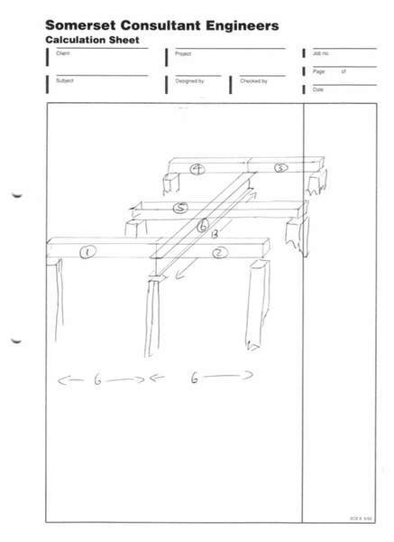

Consider a lot size of 12 meters frontage and 15 meters depth. Supposed they put 4 beams side to side and one girder at middle front to back. This means the front and back have columns at the center. Only two RC beams of 12 meters (without columns) are put at middle of lot with beam depth of 0.8 meters. Would they make the girder at middle (front to back) also with girder depths like 0.8 meters to support the whole 15 meters front to back lot size.. or would the girder be much smaller just to support the slabs? What is usually the case?
Note I'm not constructing any of this, of course but just want to understand the design of certain office near mine. Thanks.
Do you mean something like this?
So the upper floor is divided into 4 slabs 6m x 6.5m.

Yes. But with the difference there are two 12-meter beams in the middle between the front and back making up 4 side to side beams (not 3 as your drawing shows).
Also the girder is not steel i-beam but RC beam and it has same level as the side to side RC beam.. meaning it is embedded like in normal column-beam joint so the definition of girder as something supporting smaller beams don't hold. I wonder if you also defined a girder as something just to support slabs and not exactly the beams (wherein the 12 meter RC beam can stand on their own).
OK I think I understand.
There are 3 columns at the front, 3 at the back, and 4 down each side, making 10 in all. avoiding counting corners double). They are presumably evenly spaced. They are connected by a system of rc beams at the top. This network of beams divides the support for the upper floor into 3 strips 4.3m x 12m. When complete this makes an rc frame.
I would guess that the upper floor might be then constructed by lifting precast beams or floor units to span 4.3m onto the frame and screeding over the top. That would avoid slab formwork and 4 - 5 m precast beams are not that large and readily handleable by a small crane or even a digger arm. If the floor units can be cast off site or on site whilst the rc frame is being constructed there will not be some weeks waiting time for the floor concrete to cure.

Thanks. In my place. We don't use precast slabs. But simply pour fresh concrete into the floor support. Anyway. The building will be two storey. They plan to use metal hip roof on the roof of the second storey. Now do you know how heavy a hip roof is compared to using pure concrete slabs or roofdeck? Like is a hip roof with full truss support 1/2 heavier or 1/4 heavier than pure concrete roofdeck or same weight given the same building size?
Rough guess
75 to 100mm concrete slab 240 kg per sq metre = 180*12*13 to 240*156 = 25tonne to 35 tonne
metal sheet roof 6 - 10 kg /sqm plus 4 trusses at 750kg each = 3 to 5 tonnes

Don't forget that the physical form need not be a plain flat slab it can (would be?) be ribbed or otherwise strengthened by shape. And for that span it would certainly be reinforced.
But like I said we don't construct many concrete roofs in the UK.
