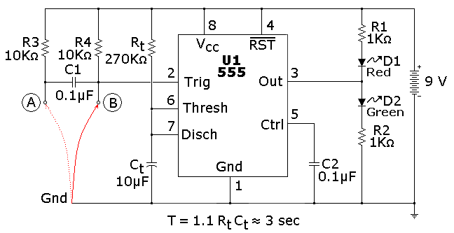

You said a period of about 1 second. Is this a fixed, known frequency, or will it vary? If variable, what percentage variation from 1 second?
It may be feasible to generate an additional pulse, one of, say, 0.6 seconds, and use this to block that unwanted pulse at 0.5 secs. Otherwise a "divide-by-two" counter could be used to eliminate one out of every pair of pulses.
"Edge Triggering" is another option.
When driven from point A this will trigger on falling edge of comparator output and ignore rising edge. You'd choose a simple DC level comparator then, comparing integrated sinewave to zero.
Sooo many circuits, so little time !
http://www.allaboutcircuits.com/vol_6/chpt_8/4.html
Ah that seems perfect! Thanks a lot jim really helpfull.
(I just found this and was having a little play with it
http://www.falstad.com/circuit/e-555monostable.html)
Must say the whole process does seem quite complicated but it does look like it will do the trick. Now just to have a little play around.
