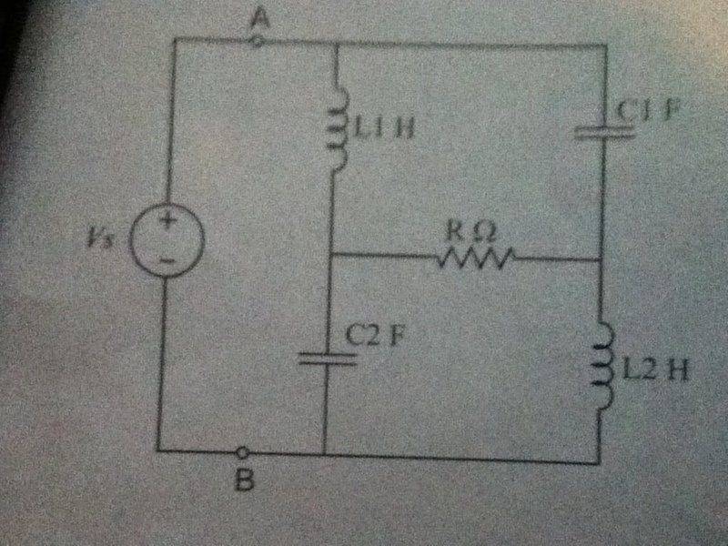

I will give a circuit of 5 passive components and an AC voltage source producing a sinusoidal voltage at a fixed frequency of omega / (2*pi) Hz.
i will post a picture asking what is being looked for along with the circuit.
z = R + jwL + 1 / jwc, jw0L + 1 / jw0c = 0, w0 = 1/ sqrt(LC), B = w2 - w1 = R/L = w0/Q, Q = w0L / R = 1/w0RC, w1 = w0 - B/2, w2 = w0 + B/2
clueless on how to make an equivalent circuit.
Welcome to the PF.
It says it wants you to find the equivalent circuit impedance Z that is formed by those components in that configuration.
There are no obvious simplifications of the circuit, so you need to write the KCL equations for the circuit, to find the Z = Vin/Iin impedance. Use the complex impedances for the L and C components...
none of the capacitors or inductors are in parallel or series with each other?
Nope. That's why you need to write the KCL equations to solve this.
