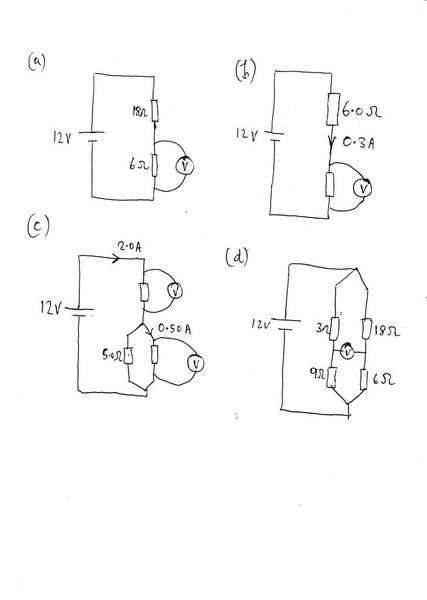

We need some diagnostic tests. Try the ones on the attached thumb-nail. Work out what the voltmeter reads in each case. Give us your answers, or tell us where – if anywhere – you get stuck.

Thanks for spending time on that. I think I have solved them, here are my steps:
a)Req=18+6=24
12/24=0.5 A
0.5*6=3 V
b) 0.3=12/(6+R)
R=34
34*0.3=10.2
c)2-0.5=1.5 A
1.5*5=7.5 V, which is equal the one on the parallel line.
d) Well eh, with some doubt:
1/(18+6)+1/(3+9)=1/Req
Req=8
12/8=1.5 A
1.5/3=0.5
Current on left line=0.5*2
Current on right line= 0.5*1
The voltage difference= 18*0.5-3*1=6
Well, you've certainly got the basic ideas! Here are some comments/alternative methods...
(b) Alternatively, p.d. across 6Ω = 6 x 0.3 = 1.8 V,
So pd across lower resistor = 12 - 1.8 = 10.2 V.
(c) And top voltmeter reads 12 - 7.5 = 4.5 V
(d) No need to evaluate resistors in parallel.
Left and right branches each have 12 V across them
So pd across 3Ω = [itex]\frac{3}{12}\times12[/itex] = 3 V,
And p.d. across 18Ω =[itex]\frac{18}{24}\times12[/itex] = 9 V,
So lhs of voltmeter is 3 V downhill from the top, and rhs of voltmeter is 9 V downhill from the top, so rhs of voltmeter is 6 V downhill from lhs of voltmeter.
