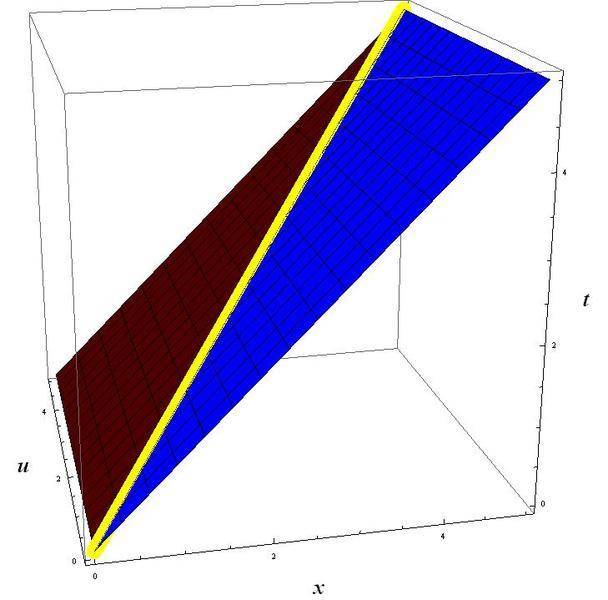

Suppose all you had to do was draw nicely, the region of integration in the u,x, and t region with t pointing up and identify those limits of integration? You can do that nicely in Mathematica. Ok, now turn the plot by a quarter turn so that now the x-axis is point up. Now identify the new limits of integration in terms of:
[tex]\int_c^d \int_{f_1(u)}^{f_2(u)}\int_{s(t,u)}^{v(t,u)} f(t,u,x)dxdtdu[/tex]
Don't worry about solving the integral just yet. Just get down clearly, the nice plot and carefully and clearly identifying the regions and the functions representing those limits of integration. You do that and I think (but have not worked it yet), the integral will fall out naturally.

I think the region is everything above that black triangle back there except I have a minor problem. When I flip the integration order, I get:
[tex]\int _0^{\infty }\int _0^u\int _0^t \cos(t^2-u^2)dxdtdu=1/4 \sqrt{\pi/2}[/tex]
but that's really ok. It's a start. Can you understand how I got those limits even if they're not correct? Now how can we fix this start to give the correct answer?

No offense, but I dont' think he's gettin' this until he plays around with my diagram for a few hours and if that one is a problem for him, he's got to go back and do some of the sample problems in the book first: sometimes if you can't work a problem, best to put it on the back burner and work on some simpler, related problems.
there is a problem with the inner two integrals.both have same limits.I think one of it should be u to ∞ or t to ∞ in order to get the desired change.I am really suspicious about the range of integration drawn.

It isn't so simple and you need a good picture to get it correct. I have changed ##t## to ##z## and ##u## to ##y## so the axes seem more familiar. So your integral is$$
\int_0^5\int_0^y\int_0^z dxdzdy$$The difficulty arises when you integrate in the ##x## direction first. So the rectangle in the ##yz## plane is the "ground" and the slanted planes form the "roof". The problem is that when you move from the ##yz## plane in the ##x## direction, you don't hit just one of the slanted planes. Sometimes you hit the plane ##x=z## and sometimes you hit ##x=y##. It depends on whether ##z > y## or ##z<y## in the ##zy## plane, so you have to break the integral into two parts.
The correct setup for that order of integration is$$
\int_0^5\int_0^y\int_0^z dxdzdy + \int_0^5\int_y^5\int_0^y dxdzdy$$Notice the ##dz## limits in the two integrals.

Yes, it's a pyramid. That's the key. Ok, now IBY, post some really nice pictures showing how it's two integrals, label everything, color-code it, the works. Try and find a machine running Mathematica:

Note now it is a simple matter to extrapolate this to the cosine integral, it falls right out.
