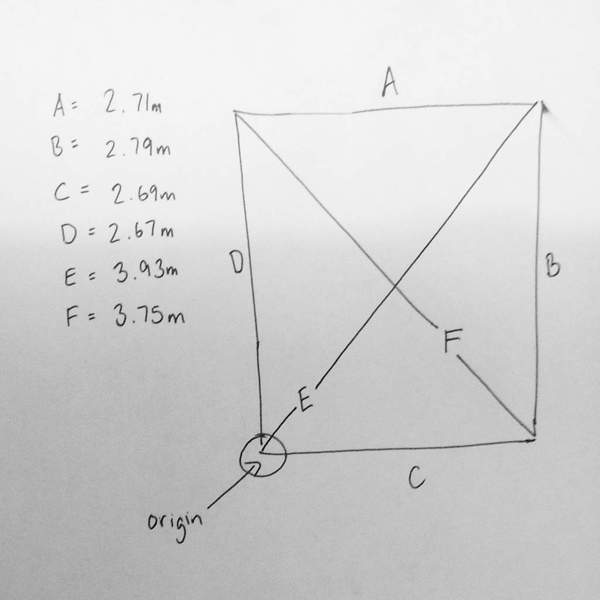

I'm trying to determine the XY coordinates of 3 corner points of a quadrilateral shape based on known lengths of the sides of that shape. I know the lengths of all 4 sides of the shape as well as the lengths of both cross lengths (effectively making two adjacent triangles). I've attached a picture to indicate the lengths of the triangles / quadrilateral shape as well as the corner of the shape that would serve as the origin of the system. I would like to find the coordinates of the 3 other corners of the shape in respect to the known XY coordinates of the origin. Any assistance would be greatly appreciated.

Lets label the corners clockwise, starting from the origin, O P Q R so we can talk about them.
Point O is easy: O=(0,0) ;)
Draw the x-axis along one side ... say you pick OR ... you know |OR| = C so point R will be (C,0)
That was easy ... the way to get the rest is with the triangles - for instance, if you knew θ = ∠QOR then you could find Q = (Ecosθ, Esinθ).
Since you know all three sides of that triangle, you can use the cosine rule to find θ.
Repeat for ∠PRO.
Surely if you got a bunch of rods with the lengths given, you would rebuild the shape in only one way?
It is over-determined but it can be solved directly from a subset of the information.
The main problem is that the axis choice is underspecified. You also need to know the orientation of the axis wrt the figure.

Sorry all and thank you much for the help.
D is the Y axis with C (roughly) being the X axis.
0.5cm accuracy should be acceptable.
In that case, O=(0,0) and P=(0,D) right off - you only need to fine the other two.
You can use angles θ=∠OPR and λ=∠POQ
You know all the sides of those triangles: so draw them out separately - how to continue should be clear.
eg. R=(Fsinθ,Fcosθ)

Just calculate the angles of triangles using the angle formulas given here:
http://en.wikipedia.org/wiki/Triangle#Sine.2C_cosine_and_tangent_rules
From there, it should fall into place...
angle1:acos((e^2+c^2-b^2)/(2*e*c));
angle2:acos((f^2+c^2-d^2)/(2*f*c));
cornerABx:cos(angle1)*e;
cornerABy:sin(angle1)*e;
cornerADx:c-cos(angle2)*f;
cornerADy:sin(angle2)*f;
origin is the origin... C,0 is another corner... Check my math :).. Ohh.. and D isn't the y axis the way I did it, so you'll have to do the work yourself. I calculated with C as the x-axis.
Thank you very much everyone. That was very helpful and informative.
