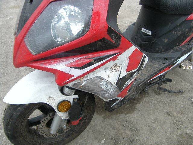

the bike had damage to the plastic paneling and the light was broken attached is a picture of the same model moped however not the one that hit the car but there saying the rider was not injured however he said he hit his legs on front panels on imapct and was rather sore
but to me he hit the car so square that the bike took most of impact via the forks against the car as the damage to the car is exactally where the imapct was and i cannot see that this is just coincidence i will take phots of my car and post

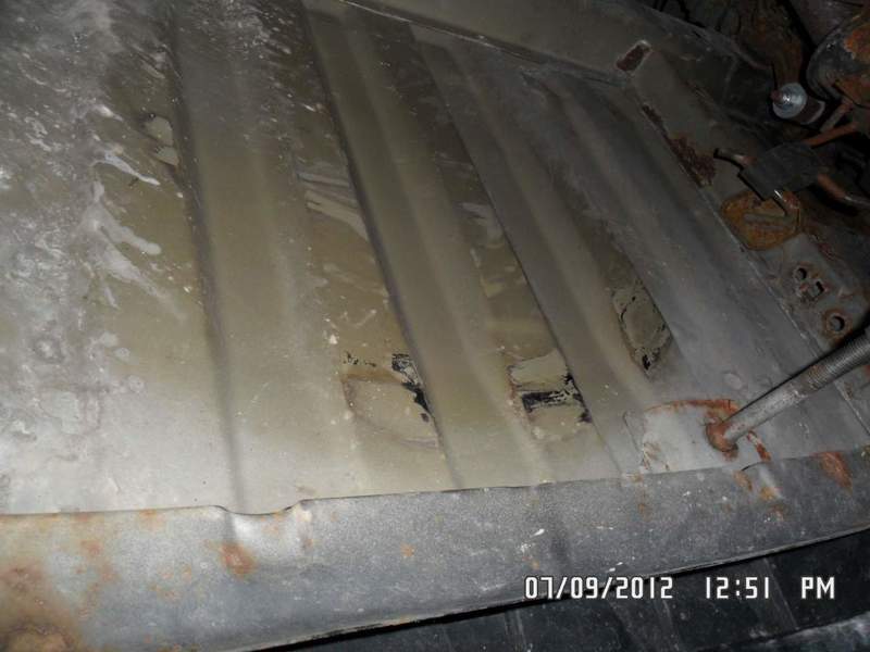

inside boot floor
although its hard to see in light there are stress marks across the bumper where impact was the wheel and mudguard to bike went under the bumper pushing the car up in the air and assuming it then pushed the spare wheel upwards resulting in the inner floor pan pushing upwards
the trim is cracked around the lock along with a bullet like small dent which i feel is down to the such pointed front above the forks of the bike
underneath of car where spare wheel is has been pushed back and back supporting welds broken giving me the impression that the front wheel of moped is 13 inches without tyre =14-15 inches has hit underneath of car causing bolt that holds wheel in carraige to be pushed forward resulting in the floor being bent upwards and at that point the moped front wheel wedged underneath the car and then stopped the bike being flung forward due to the front pointy panel against the boot causing the bullet like dent now all i need to know is what the estimated weight would have been of him hitting the car under the estimated speed.
although people seem to think it wouldn't do that if the front corner hit a centre rear of car pulling out a junction it often makes a v shape in the back of car if the damage had been previously caused by a car it would be distributed via the rear slam panel rather than from the spare wheel getting pushed up which is why the damage is only to a limited area as the moped is only a small width unlike a car has anyone got anything they can add to this or answer the question of what impact force could have been generated

KE won't help here. If the rider came to a dead stop in an amount of time you can guess (500 ms?) from a speed you can guess (25mph), than F=ma should give you an estimate.
While motorcycles generally don't have enough mass to actually hurt vehicle occupants, they can certainly damage body panels on vehicles.

Taking a stab at it.
F = ma
Mass = 180 kg
acceleration = change in speed over change in time
v = 30 mph = 13.41 meter/sec
~t = 500 ms = 0.5 s
so acceleration = 13.41 m/s /5 ms = 26.28m/s^2
So the force the little scooter hit you was
F=ma
F=180kg * 26.28m/s^2
F = 4730.4 N
Is that enough to damage your bumper?
Have you considered that maybe the swerve and emergency stop jolted you around a bit?
You'd pull more G's in a maneuver like that than you would being struck in the bumper by a moped which was almost certainly not going 20 mph when it actually hit you (as you say, the moped was in the process of stopping).
Does the moped/person have enough mass to give you a bump? Yea, probably.
Enough to cause whiplash without the driver being ejected or being slammed into the car's rear end? I doubt it.

That's almost certainly too simple to be useful. For example, it says the distance traveled by the scooter during the 0.5 s impact = (1/2) a t^2 = 3.35 meters, which doesn't make much sense.
