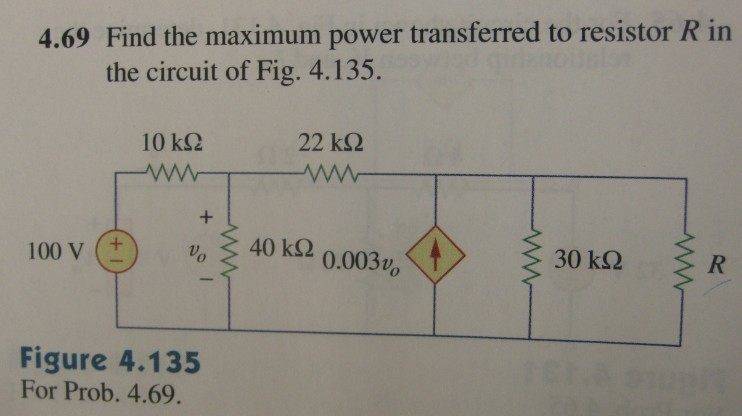

Hi Berkeman! Sure! Let me go ahead and post a sample circuit for you (Please see attachment).
So in this circuit, I find Rth = -15000/11 ohms = - 1363.636364 ohms , and Vth = - 2680/11 V (Also negative). I need to find the maximum power transfer to the rheostat R as indicated.

Forgetting Thevenin equivalent reistance for a moment, have you determined i(R) for arbitrary R?
Hello rude man! Thank you for your reply.
I have determined i(R) for sure. It is Vth/(R + Rth), right? I actually included it in the formula for the power transferred to the load resistor, namely, P = R*(Vth/(R + Rth))^2.
I even plotted the equation in MATLAB, and it turned out that P will reach infinitely high when R = - Rth (Recall that Rth < 0 now, so R = -Rth > 0). So it seems like there is no max power. Could you help me investigate if I calculated the wrong Rth? I attached the sample problem in my last post. Thank you very much!

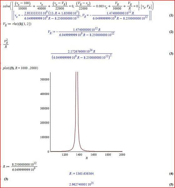

gta100,
I solved this problem using node analysis, as shown in the attachment. I don't see Thevenin helping very much. Check my node calculations. I show that when R=1363.636364, then the power dissipated in R is 2.962740001E21, a very large number. Included is a plot of the power dissipated.

Yes, the correct value of [itex]R_{thv}=[/itex] is [itex]-\frac{15}{11}k \Omega[/itex]. (Hand calculated the good old fashioned way. :smile:)
Yes the maximum power is unlimited (infinity if you like), as R_L approaches -R_thv.
The direction that Berkeman was trying to point you toward was to consider what type of real circuit components can produce a negative resistance. When you do this you'll find that in all cases the negative resistance is a result of some active component that is only valid over a limited operating range. There is no such thing as a true (or intrinsic) negative resistance.
Common examples of negative resistances are.
1. Small signal linearized examples like the tunnel diode, where both V and I are actually in the same direction, but [itex]dV/dI[/itex] is negative over some limited range of its V/I characteristics.
2. Active circuits using opamps and transistors. (remember that these always have a limited linear operating range).
3. Electro-mechanical systems like motors and generators. Again these will always be subject to a finite operating range.

Did you check your negative resistance value by finding the power dissipated by R at that negative value? If you did, you would find that the power is a small negative value, which means that mathematically, R is generating power at that negative value. However, at R=1363.636364, the power dissipated is 2.962740001E21, not infinity. See the power plot I posted above.

Hi Ratch. Your results are simply an artifact of the simulation software only evaluating the response at a finite number of discrete values of R.
For any circuit that has a negative Thevenins resistance (and a non zero Thevenins voltage) it is easy to see that if you make the external resistance equal to the absolute value of the Thevenins resistance that the total resistance becomes zero. The current, and therefore the load power, must be infinite.
As I explained to gta100 however, in reality this can never happen, as the active components forming the negative resistance will limit or saturate at some finite level.

I did not use simulation software. As shown in post #8 of this thread, I found the voltage across R by using node analysis. Then using the well known formula V^2/R, I plotted and calculated the R value at the highest power dissipation. That occurs when R is positive, not negative. Anytime R is negative, the resistor is not dissipating power, because V^2/R will always be negative. I stand by my answer of R=1363.636364, and again invite you to calculate the power the resistor dissipates at your value and mine.
What are you talking about, they're basically the same value, you just had a decimal approximation. I said to use R = -R_thv, which is positive 15/11 k-ohm. As a decimal this is [itex]1363.\dot{6}\dot{3}\, \Omega[/itex] (that's the .63 repeated).

Ratch. Are you honestly saying that you cannot see that the maximum value of,
[tex]\frac{2.173 R}{(0.00605R - 8.25)^2}[/tex]
increases without bound as R approaches [itex]\frac{8.25}{0.00605}[/itex]?
* Equation taken from your own working (with factor of [itex]10^{24}[/itex] removed top and bottom).

Sure I can. As the denominator goes to zero, the term becomes infinite. I plugged the decimal value of R into V^2/R and got a very high value of dissipated power. Had I used the exact value of R, then I would have gotten infinity.

Except for one thing. I did not "finally" realize that, I always knew that I did not have the exact value of R. Therefore I knew that the calculated dissipated power by the approximate R was finite, and not infinite.
