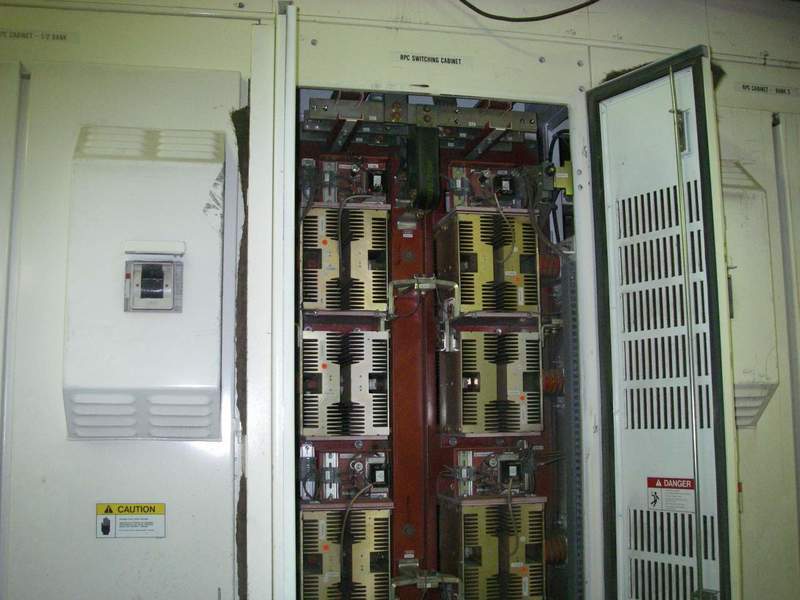

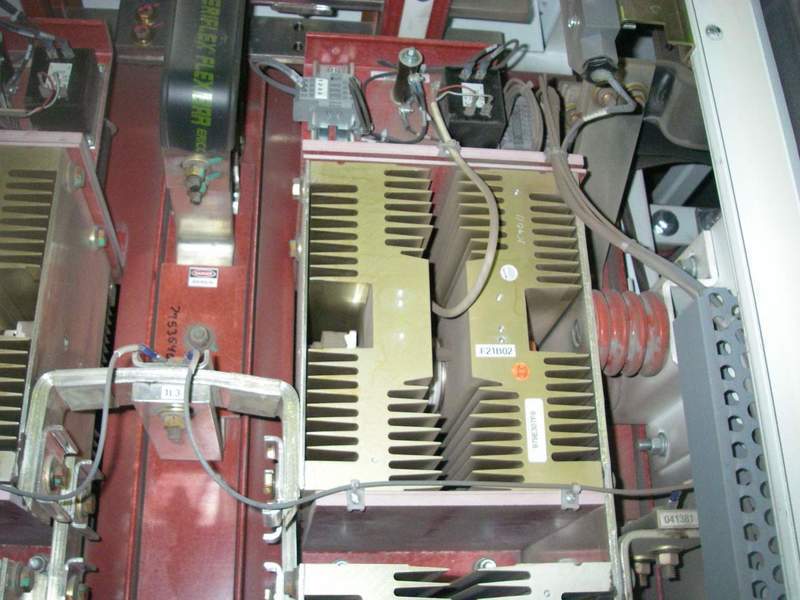

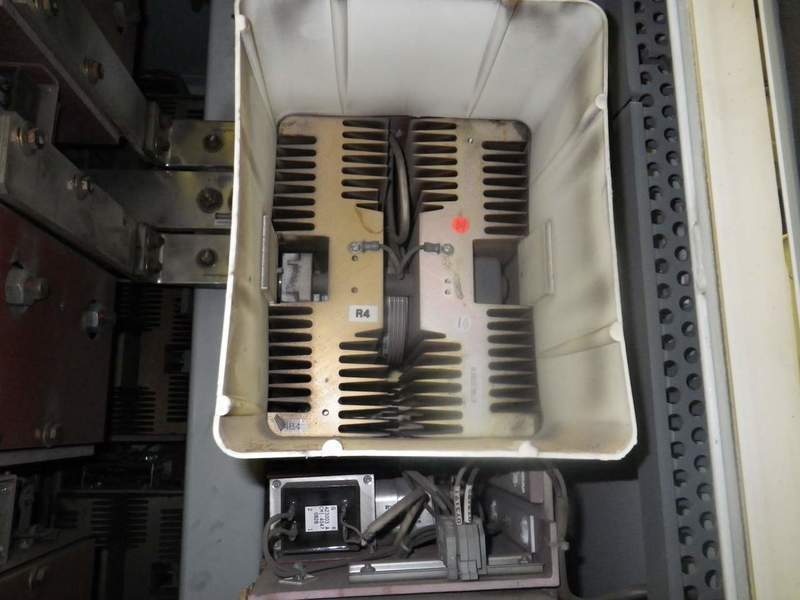

Glad you brought this up, I forgot about those circuits, I used them at work a lot.. here's a pic of the SCR in a heat sink and the snubber circuit below on the same card as the gate driver.
The pics attached show the SCR's in the heat sinks, they are hockey puck style SCR's
These SCR's convert 600 volts AC to DC to power motors used in the motion of a large mining shovel.. before I left work as an electrician there to come here to engineering school I really enjoyed my job there.
There was a case where the shovel shut down, and usually there is a system whereby these SCR's are connected to pule transformers and large 900Volt capacitors which force commutate the SCR's that power the motors and also turn on another set connected the motor armature to a resistor grid to dissipate the collapsing magnetic field. One of the bridges failed and the cabinet completely burned, me and my journeyman had to clean it all up, use thyristor testers etc to make sure the SCR's were ok and find the bad/failed ones. It was very interesting... had to apply a compound to the SCR when replacing it in the heat sink to ensure it sits flush in the heat sink, so as not to arc as well. it was a very tedious process.. at those high voltages with that pwoer transfer, there's a lot of room for error...
What was I talking about again? oh yeah the snubber circuit... there was a lot of speculation about whether a failed snubber circuit was the cause of the problem, turns out it was a shorted SCR,
You can actually see the snubber wires on the first picture, one connected to each side of the heat sink )across the anode-cathode junction of the SCR, that is the snubber connection. Had to test all that as well.
