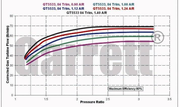

I don't understand, you are exactly describing what the turbine of a turbocharger does. The way it works is not by determining the amount pressure you can put in front of the turbine, but by knowing the capabilities of your turbine. For example, here's a typical turbine map:
There are actually 5 different turbine models on this map. For a given mass flow rate, there is a corresponding pressure ratio across the turbine. Since we all know that at the turbine exit the pressure is 14.7 psi (atmospheric pressure), then a pressure ratio of 2 means that the inlet pressure must be 29.4 psi. As you can see, for every turbine design, once you reach a certain inlet pressure, the flow is choked and increasing the pressure has no more effect on flow rate (so it only blocks the outlet of your engine cylinders).
So it is not really about how much pressure you can generate to push a turbine, but how much energy a turbine can recover from a given mass flow rate. The pressure will «adapt» itself to the conditions. You can then design the valve event of your camshaft for the proper exhaust gas conditions (pressure and flow rate).
