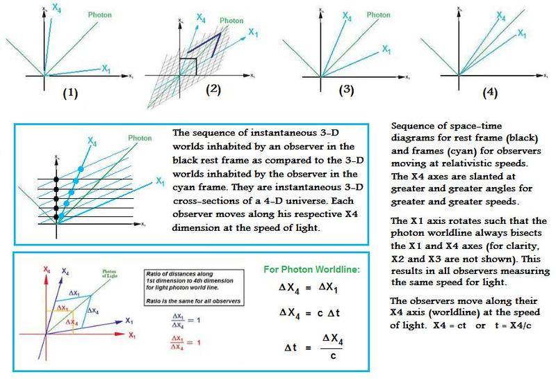

Here is an important takeaway message concerning Greene's "moving through spacetime" at the speed of light idea.
(Actually, I think it was Lewis Epstein that first popularized this "moving through [space]time" phrasing.)
If you must use the "speed through spacetime" phrasing...
  • A massive particle travels...
    through space at speed less than c.,
    but through spacetime with *speed* c [by choice of some convention].
  • Light travels...
    through space at speed c,
    but through spacetime with *speed* zero.
The word speed is used in two similar-but-distinct ways:
In space, speed is the magnitude of the ordinary velocity vector (spatial 3-velocity).
In spacetime, *speed* is the [normalized] magnitude of the spacetime 4-velocity vector for a massive particle. This doesn't quite apply for light since light's 4-momentum has zero magnitude (and thus can't be normalized to a 4-velocity)... but we can call the *speed* zero.

I read the responses above and got the gist of the conversation. Saying that we move at the speed of light is a very unfortunate way to describe the nature of what's going on. A person not fluent in the mathematics of spacetime could easily be deceived into believing that the term "motion" has the same meaning that it has in every day normal language, and it doesn't in this context.
Let’s consider what this means. In everyday language a body in “motion” means that the body undergoes a change in spatial location of a value which I’ll call the “spatial distance” during a finite period of (coordinate) time. People who speak about things moving through spacetime have a totally different meaning for this “spatial distance”. They use what is known as the “spacetime interval” rather than “spatial distance.” When this is used in that manner you have to a accept that “light moving through spacetime” becomes undefined because the spacetime interval between two points on the trajectory of a photon is zero. If you divide by the coordinate time you get “the speed of light in spacetime is zero” or if you try to use what’s called “proper time” then the “speed of light in spacetime” is undefined.
