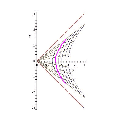

I had sort of an inisght. We can do the boosts cleanly in the Minkowskii frame (where boosts make sense). But -I don't think the resulting motion is going to represent the same motion as constant X velocity in the accelerating frame, because the coordinate clocks tick at a different rate than the accelerating clocks...

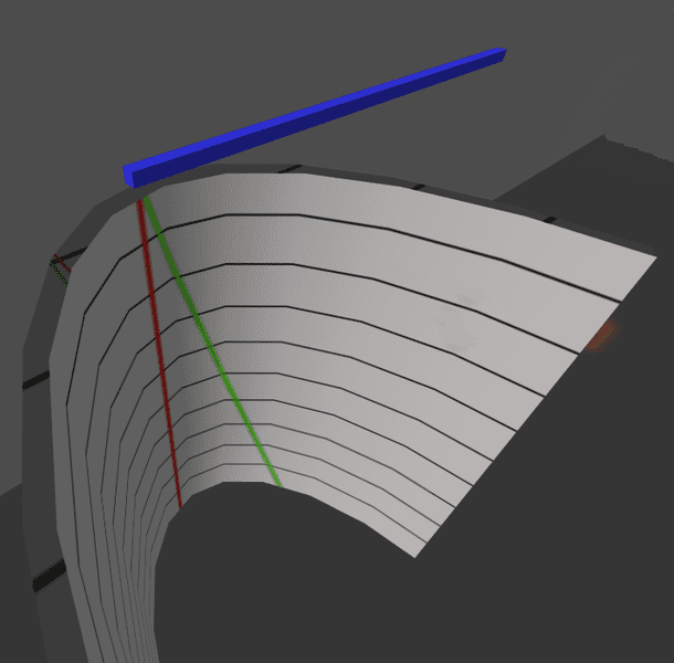

Some space-time diagrams to help visualzie what's going on since the math is so messy. The first is a standard 2d rindler diagram, with time (going up the page) and the z axis shown, which represents a single accelerating observer.
But we need t,z, and also x for the issue under discussion, so we need a 3-d diagram. We need to stack a bunch of these diagrams on top of each other. Hence, the next diagram, the 3d one.
The blue line is time. The black lines are plots of z vs time for an ensemble of rockets. The red line shows the "x" axis, a line of simultaneity for someone with dx/dt = 0. The lines all have the same z coordinate, the rocket floor is level for someone with no x motion.
[url]https://www.physicsforums.com/attachment.php?attachmentid=52344&d=1351336667[/url]
The green line shows the line of simultaneity along the x-axis for someone who is not stationary. You can see from the diagram, hopefully, why the rocket floor isn't level anymore when we start to move across it.

I'm puzzled why the second attachment isn't showing in-line in my original post - I'm going to try to get it to display here, and talk some more about its significance.
If I haven't put everyone to sleep - perhaps I've gone off on a tangent, but I think it's an interesting one.
So let's try again to get the snapshot of the secondlife model (the second attachment) to display.
The "top view" , shown in the previous post, is the hyperbola of motion of the accelerating rocket in the t-z plane, t being the Minkowskii time of an unaccelerated observer.
If you extend it in the x direction this becomes the "world sheet" of the accelerating rocket depicted by the snapshot,.
The snapshot allows us "to see the t-x plane, with t being the blue line , and x the red line. You can and should imagine these lines extending in the 'z' plane, surfaces of constant t are planes now, the same with surfaces of constant x.
A simple Lorentz transform defines how T and x mix together You can draw this on the tx plane, extend the resulting line into a plane in the z direction, and see where it intersects the worldsheet of the rocket. The result is the set of points that are simultaneous to the observer "moving" in the accelerating rocket in the Einsteinian sense.
Having the clocks be Einstei-synchornized is necessary if we are to try to understand the physics in a quasi-Newtonian way.
As can be seen, to this moving observer, the rocket floor doesn't appear to be flat anymore!
The way I'd describe why the rocket floor, supposedly "rigid", became distorted is that Born rigid objects can't rotate, and we "snuck in" a rotation by doing a sequence of boosts that was equivalent to a rotation. It's semi-well known that when you combine two Lorentz boosts in a different direction, you get a component that isn't a boost, but a rotation.

This 2d diagram has an explicit time axis (time for an observer at rest) going up the page, and an explicit z axis, going to the right.
Hmmm - I snarfed it from somewhere, it's labelled as the x axis. Oh well. That's a standard plot for accelerated motion.
The 3-d diagram adds an x axis, which you can't see in the 2 d diagram. The x-axis for an observer at rest is the red line. The x-axis for a moving observer is the green line
The time axis on the 3-d diagram is the blue line - it's the time axis for an observer "at rest".
There isn't any explicit line for the z axis on the 3-d diagram, but it's orthogonal to t and x.
Sorry if I was unclear. I was not describing your diagram. I was describing a simpler orthographic view from an inertial frame where the idea was a series of superposed time snapshots of the floor moving up the page with the object moving across the floor.
In the accelerating system an inertial particle moving along the z axis at some initial positive x would be charted as a curve with motion also in the -x direction.
So from an inertial frame the accelerating car (?) across the floor would be charted as a curve with a component of motion in the +x direction.
I was wondering if this was what you were referring to as curvature of the floor.
Within a Rindler system the metric is static and such motion would be equivalent to driving a car with constant velocity some distance on a flat road on earth. Effectively inertial, disregarding the constant g . In that context would you say the road was curved?
Since a line of simultaneity is limited to an instant of equal proper time by definition I am not sure how to interpret the green line that extends through a range of coordinate time per your blue line?
