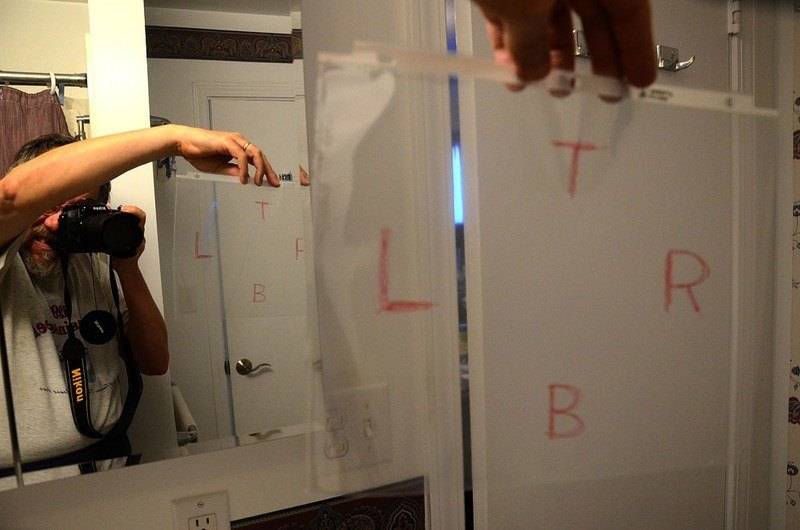

DaTario said:
Why a plane mirror image exchanges right with left but does not interfere with up and down?
See the attached picture. Are left and right exchanged between the plastic sheet and its reflected image?
Nice one! :biggrin:
If the L letter you draw was a man, he will understand its image as facing him with the left-right exchanged. But now I guess we here touched a fundamental point. Mirrors provide front-back exchange. This effect can be presumed by the symmetry the plane have. And this front-back interplay yields this interpretation of left-right exhange.

I also believe that the number of eyes has no determinant role to play in this discussion. I explained that your face in the mirror looks like a person who has turned around a vertical axis by 180°, as we are used to. If you do the same with for example playing cards then you can turn it also around the horizontal axis and the illusion is gone. However, it seems that somehow you suddenly understood it. :wink:
To see more clearly where the usual left-right reversal in a mirror image comes from, first note that in my picture, the letters are written on the side of the plastic sheet that faces me. Now imagine replacing the clear plastic with cardboard. We no longer see the letters in the mirror because they're on the "wrong" side of the sheet, facing away from the mirror.
To make the letters visible in the mirror, we need to flip the sheet around. If we flip the sheet horizontally (around a vertical axis), we see the usual "mirror-reversed" image. What happens if instead, we flip the sheet vertically (around a horizontal axis)? :smile:
