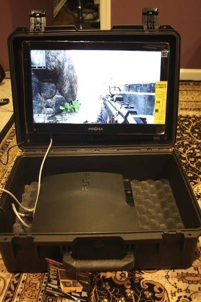

I am wanting to build a custom PS3/TV combo inside of a pelican 1500 or pelican iM2600 case with a 20 inch TV inside the lid for a deployment to Afghanistan. Has anyone done this (besides Ben Heck) who didn't use heavy machinery to cut out frames and all of that? I don't know if best options would be to disassemble everything, leave it intact, or what. Any help would be awesome, thanks!

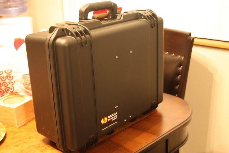

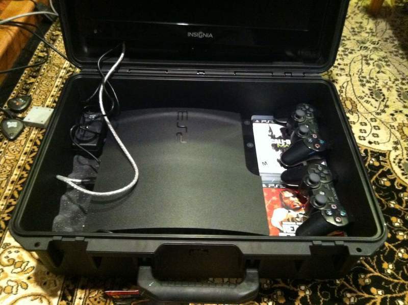

Well, got it figured out and it was a lot more simple than I was anticipating. I mounted a 19 inch Insignia TV (1 5/8'' thick) into the lid and bolted through the lid into the wall mount bolt holes of the TV. It was a pain to get it lined up but I got it finally, on that note do any of you know the best way to line up holes in something (the back of the TV in this case) and mark where the holes in the lid should be drilled? I dabbed face cream on the holes and put the TV down and drilled where the face cream pressed onto the lid. It worked but it is very slightly crooked and I would love to avoid that next time if possible, I'm sure it is.
Anyways, I am able to keep the PS3 from moving around when transporting by it sitting on a piece of foam and then when closing the box put another piece of 2 inch thick padded foam on top and letting the TV rest on that which presses just hard enough on the PS3 to keep it from moving. It looks a lot less complex than what I wanted but it works perfectly. Pics attached, thanks for the ideas guys!

To drill the holes in the correct place you can use a template, out of paper or card or similar. Just hold it up to the back of the TV, poke holes in the card with a pen or something, then put the card onto the case and mark the holes. The mounting holes on a TV are also a standard distance apart, so you could just measure and mark directly onto the case if it's reasonably flat.
