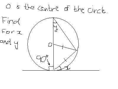

hey, can anyone help me with this problem. I just can't concentrate hard enough to get it. Please, help me. I would really appreciate your help.
The drawing is attached in a file
Thanks.
Rahul

Rahul, when you have a new question it is better to start your own thread than to "hi-jack" someone elses thread!
In you picture, it appears that you intend a single line through O- a diameter. If the two "vertical" lines are not intended to be a single line, then I don't see how you can find angle y.
The marks on the lower triangle, I take it, show that the two segments are congruent. That being the case, since one of them is a radius of the circle, and the third line is a radius, you have an equilateral triangle. All angles, including the angle at the bottom are 60 degrees and angle x has measure 90- 60= 30 degrees.
Assuming I am correct about the long line through O actually being a single line: a diameter of the circle, then the large triangle is a right triangle. The angle at the bottom is 60 degrees, as said before, and the angle at the top, angle y, is 30 degrees.
