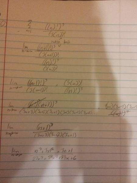

Ʃ (((n)!)^3)/(3(n))! Use the ratio test to solve
n=1
So first i put it into form of (n!)^3/3n!, then applied ratio test.
from ratio got ((n+1)!)^3/(3n+1)! times (3n)!/(n!)^3
from here I am on shaky ground
i go reduce the terms to (n!)^3(n+1)^3/(3n!)(3n+1) times (3n!)/(n!)^3
i then end with lim n->∞ (n+1)^3/(3n+1)
My main two questions are did i reduce terms correctly and cancel, and how to take the limit of the remaining term.
Forgot to mention on my calculator it says the limit goes to infinity but i need to know how to actually show steps, etc

You are being a bit too sloppy. There is a difference between 3n+1 and 3(n+1).
Sorry i attached a pic of the actual prob if that would help
Also i don't see where i have that problem i took (3n+1)! to (3n!)(3n+1)

You do have that problem. (3n+1)!/(3n)! is (3n+1). (3(n+1))!/(3n)! is not the same thing.
Okay i worked it again and tried to follow what you said hopefully
I attached a pic of my work, srry for the sloppiness :P

Yeah, I think you've got it. The limit isn't infinity, right?
No I am getting 1/27 when i divided the highest terms
