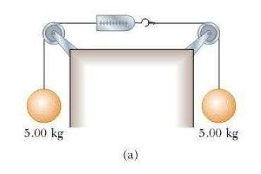

This is something I've long "gotten over",meaning it was in the introductory lessons in college,I forgot about it,but honestly it never "clicked".
My teacher gave me a real bad explanation.
In the attached picture,the two objects with m=5kg ,are pulling a third object,or to be precise a dynometer.
What amount of force will the dynometer show?
The teachers answer was 50Nm(49.05Nm) ,but somehow the number 98.1Nm is going around my brain.
I don't think I have enough credentials to contradict him,and honestly don't know If I am right,doubt it somehow,but there's this part of my brain that just can't let it go.
So ,if you would be so kind as to give me the correct answer and a good explanation.
Thank you very much.
(Also,I apologise for any technical terms I might have misspelled or missed entirely,English is my second language)

Thanks.
I gave it a good solid thought for the past hour or so,and gotten to the same conclusion,but was still a bit iffy,this assured me though.
I'm actually a bit ashamed now,strange how sometimes we can't even grasp the simplest of things but yet try to go for the more complex.
Oh well,all a part of the human experience...
EDIT: To elaborate my train of thought,in case someone else might be going through the same konundrum.
Since I expected 49.05Nm from one weight,98.1 was an immediate thought linked to two weights,but it took me an imaginary wall to realize that the weight was,let's put it,all ready there,just in a different form.
And of course then it hit me that I was measuring the force of reaction and not the actual weight.
