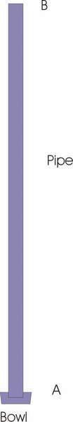

hi to everyone,
i have the following question, see attached image.
a vertical pipe containing water is exactly 28ft tall. at the top (A) the pipe is tight shut. at the bottom (B)the pipe is open and ends in a bowl of water.
since no air can enter the pipe, the water remains within the pipe and does not flow out of the bowl.
up to what height can this setup work? i.e. at what height will the pressure inside the pipe overcome the outside pressure and will flow out.and is there a connection between the amount of water in the bowl and height of the water column inside the pipe.
thank you
What do you think? How can you find the hydrostatic pressure at the bottom of that column of water? How does that compare to atmospheric pressure?
i guess that at 33ft (1 atm) the water column pressure will equalize with the outside pressure . At 34 ft height, the additional 1ft height will flow out leaving 33ft of water.

alibaba2 said:
what about the relation between the volume of water in the bowl and the height of the column (volume in the column)?
Volumes don't matter. All that matters is the height difference between the top of the water in the pipe and the top of the water in the bowl. That determines the pressure difference, and if it's less than atmospheric then the column of water in the pipe can stay put.

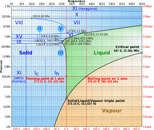

Equilibrium height won't simply be the height needed to equal atmospheric pressure though. The top of the pipe will not be a vacuum, it will be water vapor. The height of the column in equilibrium will be proportional to the difference between atmospheric pressure and water vapor pressure. How is the water vapor pressure calculated?
@ 20 deg C water boils at 2kPa.
Vapour pressure will depend on the temperature and the diameter of the pipe.
