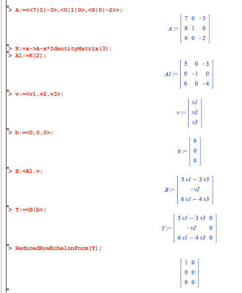

Hi We have a matrix A (picture), the eigenvalues are λ1 = 4 and λ2 = 1 and the eigenvectors are
λ1 : t(1,0,1)
λ2 : t1(1,0,2) + t2(0,1,0)
I have to examine if there's a column vector v that satifies :
A*v = 2 v I would say no there doesn't exist such a column vector v because 2 isn't an eigenvalue:
Av = λv
so
Av = 2v
but we know that λ is 4 or 1 and not 2
Am I wrong ?
I would be nice if someone could give me their opinion :)

When I solve it I get
v =
(1 0)
(0 0)
(0 0)

You cannot use Maple in this way. You should use linsolve(A1,b) or LinearSolve(A1,b). Or better, do it by hand.
I don't understand what you mean by that. Your vectors before were single columns of three numbers. How could v be two columns?
