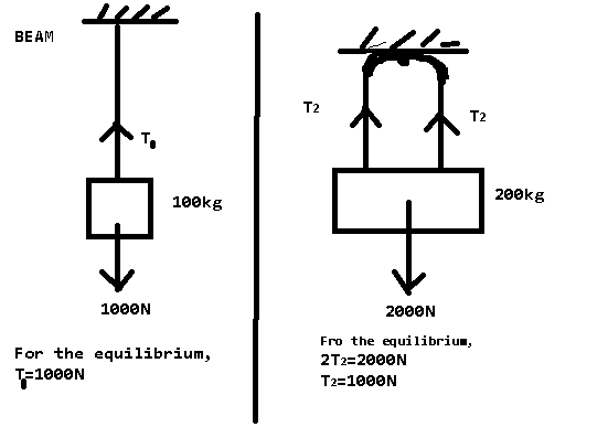

I have a practical physics question. I'm an industrial abseiler, and on the course today we had this question which not even the instructor can answer.
If we have a rope connected to a horizontal beam. Say the rope can hold 100kg before it breaks.
Now, if we take the top end of that rope and trace it over the beam and back down to the mass so now we have it doubled over, apparently we can now hold 200kg mass before it breaks. This makes sense if each strand of the rope was independent, but they aren't because its actually one rope doubled over the beam. So I'm thinking, wouldn't there be over 100kg acting on that point in opposing directions?
I have attached a diagram.
Thanks.
David.
In both situation the tension of the rope is 1000N(100kg)
Even in the second situation you will be able to hold only 100oN tension.You won't be able to double the maximum tension it can hold by bending the rope.But you can hold more masses by dividing the force created by the mass on rope,just by bending it into two or there..etc
I have use the brackets to show that 1000N has came from 100kg mass.
and also I've taken the gravitational acceleration as 10ms-2.
The whole system can hold a mass of 200kg(weighing 2000N) in the second situation...But even in that situation the rope can hold only 100N
Shalikadam:
I didn't say we have increased the maximum tension it can hold. Basically what you have done is explain the situation so others can understand what I'm asking. Thankyou for that.
So I want to understand the physics behind this phenomenon. Most people who do this course ask this question. If we look at the top centre of the rope in the second diagram of Shalikadam's one would think that T2a and T2b are antagonistic Tensions and thus adding to give Tmax only with 100kg. But in fact as described in this picture we can hold 200kg before we reach Tmax.
Is this something to do with breaking the vectors down into artesian coordinates, and that right up the top where I thouogth the rope would have broken?
Explanation in vectors and forces and tension would be appreciated.

All I can think of is that, right at the apex of this rope, the rope is actually horizontal, and so if we break the vector into x and y components, there are no x components up the top and so way up the top at the apex where the rope is horizontal momentarily, there is not tension. That sounds odd though, to me. So does Tension decrease from when we get close to the apex as we approach the apex?
David.
It really depends upon friction.
If your rope is (relatively) free to slide over the top of the beam then the beam acts as a pulley and the tension is the same in both drops and acts as shalikadm has presented.
If however you take several turns around the beam so that the rope cannot slip the forces in each drop will be independent and the capacity doubled.
In the indeterminate situation where there is some friction the tension can be different in each drop.
Does this help?
This is a quite common confusion about tension.
But think about it, the same can be said not only for the point at the top, but for every point on the rope.
And you can do the same "analysis" for the situation with only one piece of rope (first drawing). If you take an arbitrary section of the rope, there is a tension "up" and one "down". If the weight is 1000N, what will the tension in the rope be ? Will the rope hold if the breaking tension is 1000 N? Or you only can hold 500 N? How come nobody raised the question about the first case?
In the second case, the beam is the one supporting double load.

Can you specify what do you mean when you say that the capacity is doubled? With a rope that breaks at 1000N tension, what will be the maximum load in the two cases (without and with friction)?
The attachment shows a bar weighing 1500 kg suspended by two independent ropes of breaking force 1000kg.
This is a stable situation since each rope carries 750 kg force.
If for some reason one rope breaks the other will be unable to sustain the load and also break.
Involving friction allows this support situation to occur with a single rope.
