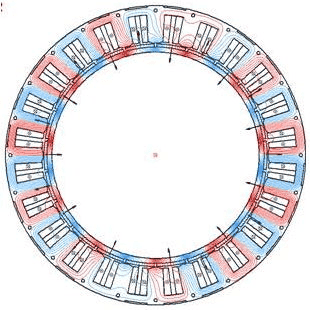

I am very new to this, so if my questions sound a bit stupid please point me in the right direction.
I want to build my own 2.5 kW magnetic generator, but would like to understand a bit more how this works. Please see attached picture. I will be using the 24 magnet / 18 coil configuration, and the coils will be connected in a star formation. So, I have 18 coils, or 9 pairs. When I move the magnets in a clockwise direction, in one turn, 22 magnets will cause a changing magnetic field on each coil. Lets say I will rotate it 3 times per second.
I hope this does not sound confusing, but which one is my power rating:
1. 18 coils x 1 magnet moving over it (1 changing magnetic field)
2. 18 coils x 22 magnets x 3 revolutions

None of these are power ratings. The number of magnets and coils and RPM will give you the frequency of the generator output. The power depends on the EMF generated by coils, and that depends on their construction and the magnetic field in the generator. It also depends on the resistance of the wiring. And, finally, it must be less than the mechanical power fed to the generator's shaft.

I think you are trying to go to deep with this. What I am after is a simple direction - if I have 18 coils, and I move the magnets once in a clockwise direction, so each coil "experiences" 1 magnetic field change and an EMF is induced, is this my power rating (and yes, I understand there are many variables)? Or is my power rating 18 coils x 22 magnetic field changes with an EMF induced (1 rotation)? Or is my power rating 18 coils x 22 magnetic field changes x 3 rotations with an EMF induced?
I am after what I should aim for with induced EMF per coil per magnetic field change to achieve a power rating of 2.5 kW.

The EMF of one coil is about ## 2fn NB_0S ##, where ## f ## is the number of revolutions per second, ## n ## is the number of magnetic poles, ## N ## is the number of turns in the coil, ## B_0 ## is the max. magnetic flux density, and ## S ## is the crosssection of the coil.
You have got 3 phases, so each phase must generate 2.5 kW / 3 = 830 W. Total resistance is 3 Ohm, thus 1 Ohm per phase, so total EMF per phase must be about 30 V, or 5 V per coil, if they are connected in series.
Since N and S are not specified, I cannot determine if your setup will really generate 5 V EMF per coil. But you could use the formula above to figure out N and S required for that.
Note this is a very rough estimate, because much depends on the true geometry of the magnetic field.

Perfect, thank you, this is exactly what I was after! With regards to poles, I will use the layout in the picture in my first post. Blue will be North and Red will be South.

The EMF frequency is the mechanical frequency multiplied by the number of magnets. With 24 magnets and 3 revolutions per second, you get 72 Hz.
Angular velocity (of the rotor) is the mechanical frequency multiplied by 2 pi. For 3 Hz, that is about 20 rad/second.

The formulas are about the same, but using the web site's formula, you need to factor in the number of magnetic poles into "seconds". This is because the more poles you have, the more frequently the field alternates. Note it is number of "poles", which is twice the number of magnets.
"Cross-section" is the same as "area". I think your coils will be roughly rectangular or perhaps trapezoidal in shape, and it is easy to compute the area of these shapes.
Reducing resistance, you increase the power. The formula is ## P = \frac {E^2} {R} ##. Note this is max power, which is achieved when the generator's output is shorted.

First of all, is that 22 or 24 magnets? You started with 24. I think this is the correct number for a three-phase generator with 18 coils.
Second, 24 magnets have 48 poles - this is the number you should plug into the formula.
Lastly, 0.015 sq. meters as a coil cross-section is suspicious. This is the area of a square with about 0.12 m a side; you have 18 coils, and you must have gaps between them; so 0.12 m x 35 = 4.3 m; this is the circumference of your stator, meaning the diameter of the generator is greater than 1 meter.
I would assume you want your stator about half a meter wide, then its circumference will be 1.6 meters, dividing by 35 we get 0.05 m the coil diameter, and 0.0025 sq. m its area.
So: 2 * 3 Hz * 48 poles * 317 turns * 0.35 Tesla * 0.0025 sq. m = 80 V per coil. That's 16 times greater than you need, so you need to reduce the number of turns accordingly.

By the way, assuming your coils are square with 0.05 m a side, and 20 turns per coil, you get 4 m of wire per coil, and 72 m total wiring. That has to be less than 3 Ohm, so that means the wire must have no more than 0.04 Ohms per meter. Assuming you are in the States, that means gauge 20 copper wire.

I see where I went wrong. From the picture in my first post, at the top I have two North poles next to each other, and at the bottom I have 2 South poles, so I assumed that these wont induce an EMF as moving 2 north poles over the coil, only 1 would induce an EMF. For my cross section, I just took the area of my magnet, again a bit wrong there!
Awesome, another step closer. I have adjusted the formulation to 2 * 3 Hz * 48 poles * 20 turns * 0.35 Tesla * 0.0025 sq. m = 5.04 V.

Are your magnets really that huge? 0.1 m x 0.15 m? That's a tad bigger than two iPhone's side by side!
